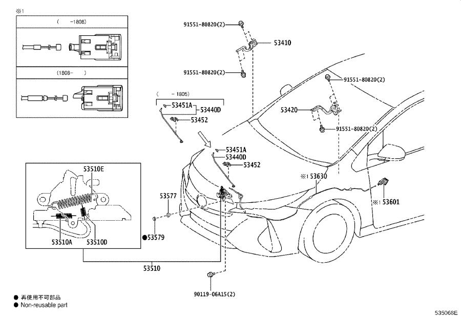

    Sounds like broken/disconnected, mechanical cable. I know, we might all be wrong. Anyway, attached is from 4th gen Repair Manual. Unless there's something tricky with the Prime.

    The owners manual for a 2017 Prime says in order to jump it when you have a dead 12v battery you open the door and pop the hood. Without power. So if it does not work there must be something disconnected or jammed.
    5697BCF3-0B31-4E62-893B-3FA7A3EFCF89.jpeg 55D42CC0-16B8-469D-BF31-DECA54323EBC.jpeg

    Has somebody already pulled the hood release? That would make a subsequent pull feel like "pulling on air."
    Maybe it's worth checking to see if the latch has already been released and the hood is just being held down by the auxiliary catch lever, the one you push out of the way with your finger.

    Probably a very weak hood spring. Just need to sick your fingers underneath and lift. If you've got big sausage fingers; gently use a plastic pry bar. One of those tools to take apart interior molding.
    If the hood still doesn't release; have someone pull on the release cable while you lift the hood.
