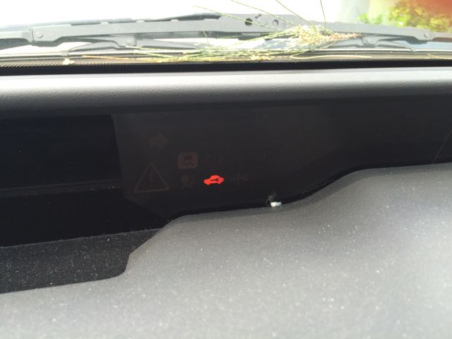

    I tried all of the above, still no success? It was so easy to get part A to work. Any more thoughts? Some questions.
    How critical is 1.5 seconds? How do you mange that aspect of it?
    How long to hold the final "Within three seconds, press the lock key on the NEW fob" one second, longer?
    thanks

    It is my understanding that that is the symbol for add mode.
