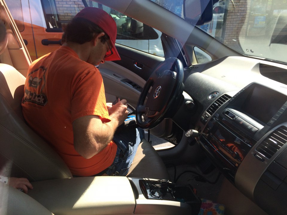

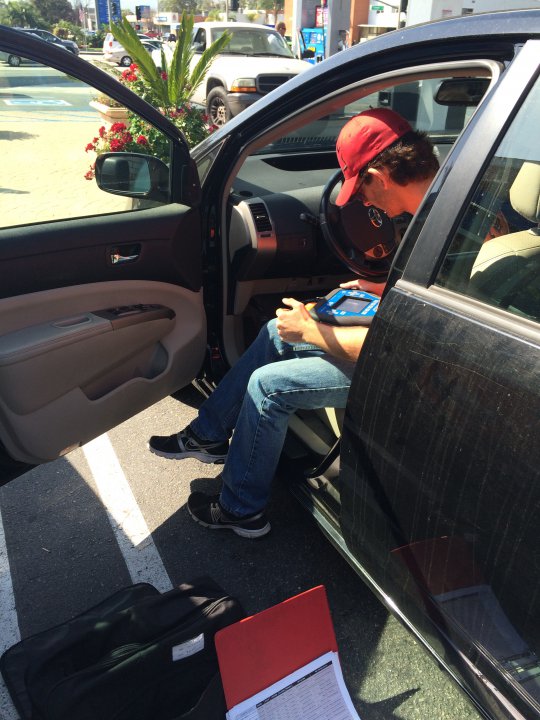

    Well, to make a long story shorter, I decided to call Pop-A-Lock because I live in LA. And you know what, the truth is you can get it all done by them for pretty much the same price. I had a black logo fob and perhaps it really does not like matching up with the Gen II 2007 Prius, the Pop-A-Lock guy said this is the hardest generation to reprogram.
    So I returned the fob I bought on Amazon for $101 and made an appointment with Devin in Torrence and he sold me a used silver logo fob ($65) and reprogrammed it on the spot for another $65.
    I was amazed how long it was for the gadget to complete the job, almost 30 minutes of waiting. But, it was so worth it in my case.
