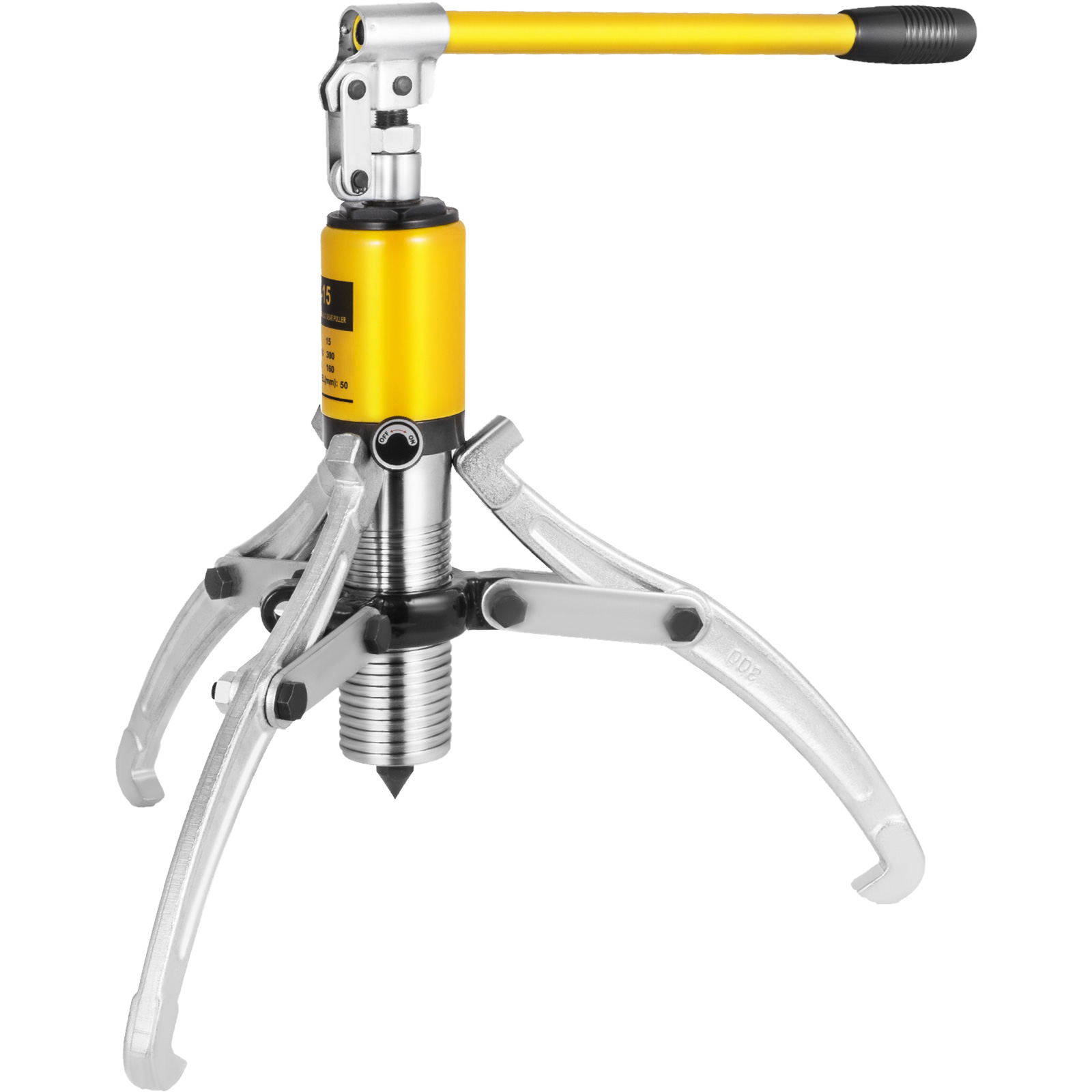

    What is the best way to remove a rusted hub from a knuckle? I dont have a heat torch or a 2000 ton hammer press.
    Could I use one of these hub removal kits?

    Just a fancy wheel / gear / pulley puller.
    I think that is what an independent shop did on one of our vehicles suffering significant road salt corrosion. Let the penetrant soak in overnight.
