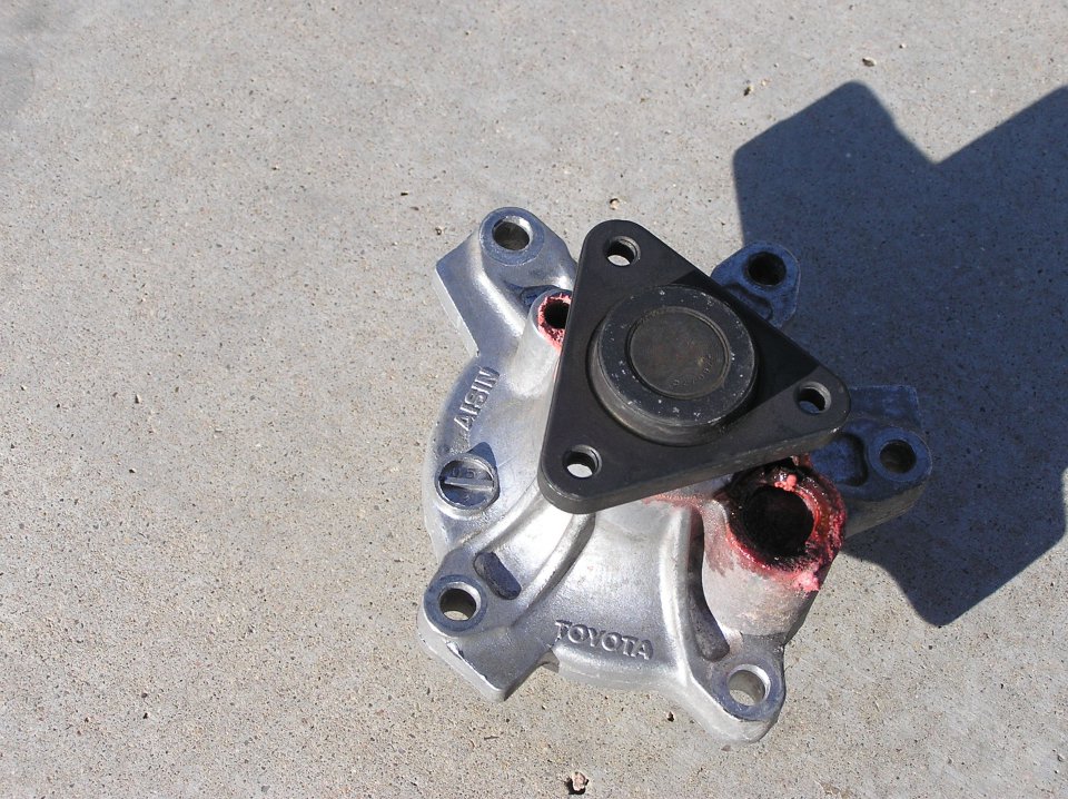

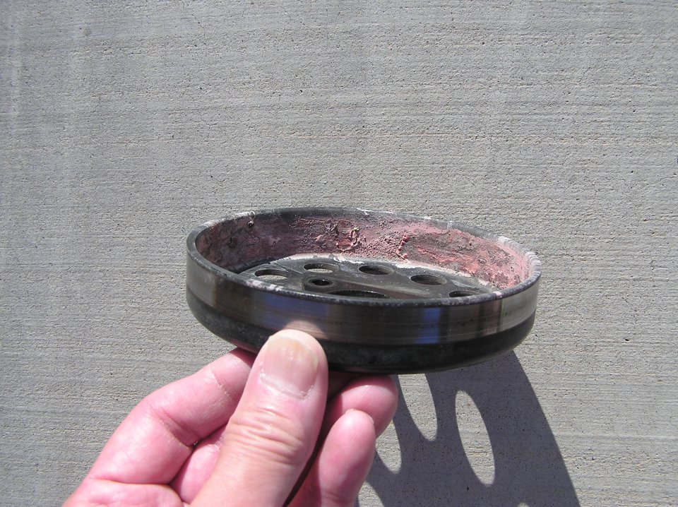

    My daughter is now driving the 2007 and at a recent dealership oil change (Rancho Santa Margarita Toyota, south OC, CA), she was informed that the engine coolant pump was leaking and that it would cost $600 to replace it. I asked her for photos to confirm this problem and was satisfied it was real. So I told her I would change the coolant pump myself. I bought the correct pump for $57 and the serpentine drive belt for $14 plus shipping via weborder at Autonation Toyota Gulf Freeway (Houston, TX).
    She's visiting now and drove the car to Tucson, so I changed the pump this morning, with the odometer showing 73K miles. Attached is a photo showing coolant seepage at both weep holes, similar to Mylar's photo in post #28. There was sufficient leakage so that a light spray was deposited on the underhood sound insulator pad and a pink line was painted on the air conditioner compressor as well as other deposits here and there on the compressor housing. Of course the inside of the coolant pump pulley was coated in dried antifreeze deposits.

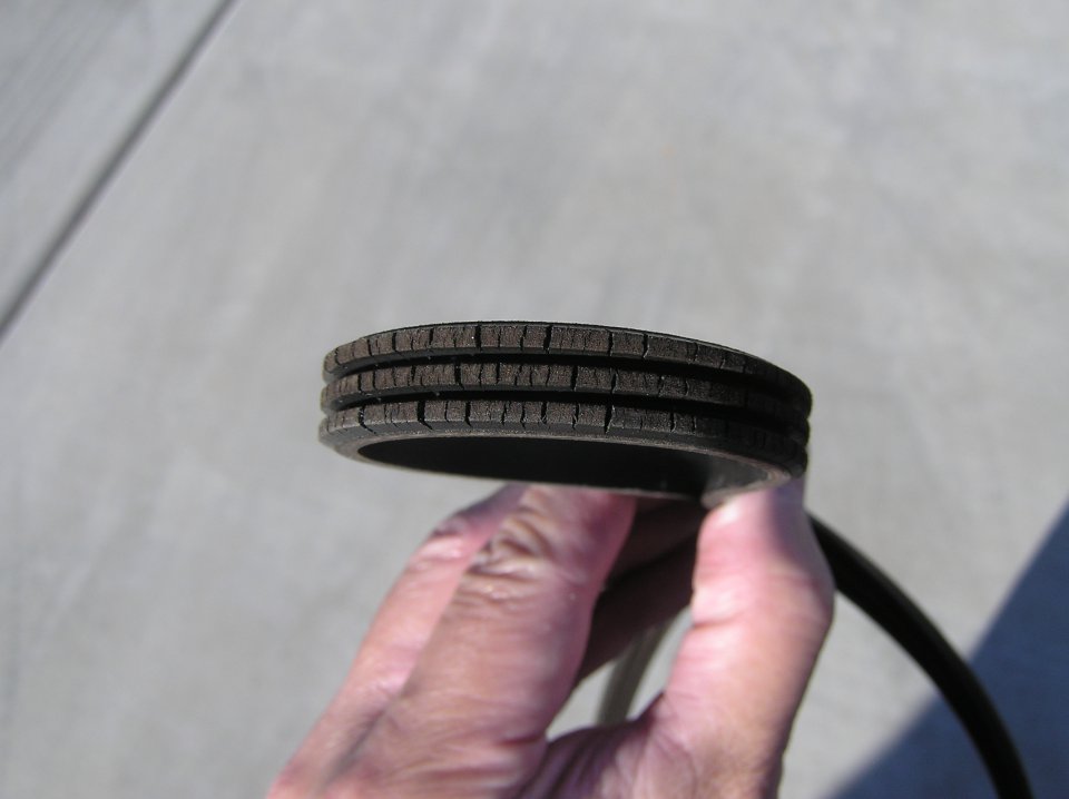

    I provided a photo of the original serpentine drive belt which shows lots of cracking which is to be expected at this odometer reading and age. The outside surface of the belt was starting to glaze.
    Note that when the new serpentine belt is installed, that provides excellent holding force on the coolant pump pulley which makes it very easy to tighten the pulley bolts. When removing the bolts, the old belt will likely slip due to surface glazing, so I use a long screwdriver inserted through one of the pulley holes, to more-or-less lock the pulley in place. You can also get a special tool to hold the pulley in place but there isn't much room to hold that tool and also work on the pulley bolts with a box wrench or a socket wrench.
    It is really helpful to be left-handed when removing the pulley bolts and the pump mounting bolts/nuts.
    I had removed the engine undercover because I had expected to open the radiator drain valve. However it turns out that valve is extremely hard to reach. I recall that the 2004 valve is easy to get to, so I don't know if the 2007 radiator was redesigned or if something was moved into the way. I ended up just pulling the coolant pump without draining the coolant, so I got a nice gush of coolant, some of which was caught in a drain pan while the rest coated the garage floor. I hosed off the latter with water.
    I was able to install the serpentine drive belt from above, so in retrospect there was no need to remove the engine undercover plastic panels. I could reach on both sides of the crankshaft pulley to satisfy myself the new serpentine belt was properly seated.
    Some posters have complained of difficulty in loosening the idler pulley 14 mm locknut, so I provided a photo to show what I use: a 14 mm 6-point socket, a 3/8" cheater bar, and a piece of steel pipe to extend the length of the cheater bar. This is very simple, and has worked really well on all three Prius that I have owned.
    Other posters have reported that thread sealant was used on the locknut. I noticed some red paint on the end of the nut, but I believe that paint was used to show the nut was torqued down. The reason for my belief is that there was no red substance on the threads.
