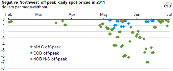

    In many places, especially in coal-dominated states, the baseload at night is far in excess of demand, and if given the choice the power companies would rather use coal than wind. It is one of the reasons the bulk-power rate can actually go negative.. power companies paying others to take the power because they want to avoid shutting down plants.
    Here an interesting chart of prices from an EIA article
    This is from the northwest, but negative bulk pricess happen in multiple places.
