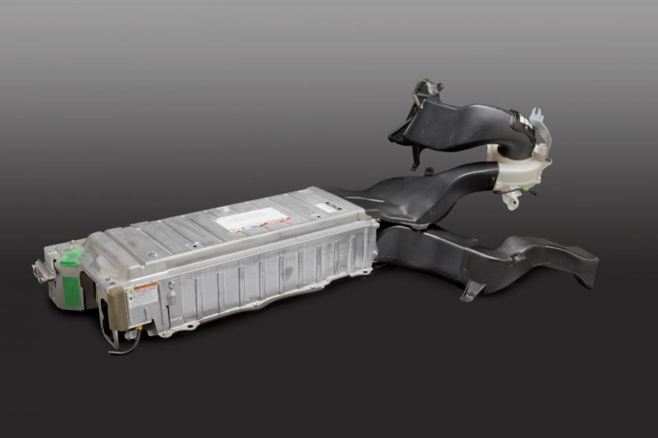

    Since it's cold again, it's no coincidence that I have also been thinking about this again. But it is a coincidence that last week my wife was shopping for a new vacuum cleaner. She had her eye on a model with over 2000 W. I pointed out to her that that is more than three horsepower, enough to power a small motorcycle, and a ridiculous amount of power just to pick up a few grams of dust. So I persuaded her to order a different model with two thirds the power, but which performs just as well, because it is more efficient.
    So thinking about the enormous inefficiency of vacuum cleaners, which waste most of their power by heating a large amount of air by a small amount, led me to the idea of using a vacuum cleaner to heat the HV battery. I think that a vacuum cleaner is very close to the ideal heat source to preheat the HV battery:
    1. A vacuum cleaner has about the right amount of power. Based on NREL's calculations, I estimate that 2000 W of power, assuming 50% heat transfer efficiency, would heat the HV battery by about 30° C in about half an hour. That is slow enough to ensure fairly even heating throughout the individual cells, but fast enough that it can be effective on fairly short notice.
    2. The high airflow ensures even heating throughout the battery pack. One of the worst things for the health of a battery pack is uneven charge between cells, which can be caused by uneven heating.
    3. A vacuum cleaner has of course, very conveniently, a built in air filter, which would slow the build up of dust due to the increased airflow in the battery pack.
    4. Normally, vacuum cleaners do not operate at such high temperatures as most heating devices, so the fire danger might be lower.
    5. The installation, I think, would be relatively simple.
    The basic idea was already mentioned earlier. More specifically, the idea is to tap in to the battery ventilation exhaust duct as close as possible to the battery, draw the air from the battery through the vacuum cleaner, whereby it is heated as it cools the fan motor, duct the exhaust air from the vacuum cleaner through a one way valve, and into the battery ventilation intake duct. The heated air is then drawn through the battery by the vacuum sucking at the battery ventilation exhaust duct. So the air is re-circulated in a more or less closed loop. And of course a thermostat or timer should be used to prevent overheating.
    If the duct from the vacuum is not routed to and sealed around the battery ventilation duct intake grill on the right rear seatback but tapped in to the duct itself, then a second one way valve, in the battery ventilation intake duct upstream of where the vacuum cleaner exhaust is tapped in, may or may not be necessary, depending on how much air can exit the cabin through other openings. Without the second one way valve in the battery ventilation intake duct, at least a small amount of heated air would escape through the battery ventilation duct intake grill on the right rear seatback. This might be either a loss or an added benefit, depending on your point of view.
    Some vacuum cleaners are equipped with a blower port to which a hose can be attached. With other vacuum cleaners, some ducting would have to be attached around the exhaust openings, or the entire vacuum could be encapsulated to capture all the exhaust air.
    One thing that I'm not so sure about is how much the intake airflow to the vacuum cleaner would have to be throttled, in order to consume the required amount of power. Electric motors, when not working against a mechanical (or air) resistance, do not consume much power, even at high rpm. Presumably vacuum cleaners are designed to develop max power when working against the air resistance of the floor cleaning attachment while it is resting on the floor. Perhaps using a small diameter duct to the vacuum cleaner or cutting only a small hole when tapping in to the duct would produce the desired effect.
    PS Here's a nice picture of the battery and ductwork of the 2nd gen. Prius from the Toyota press site:
