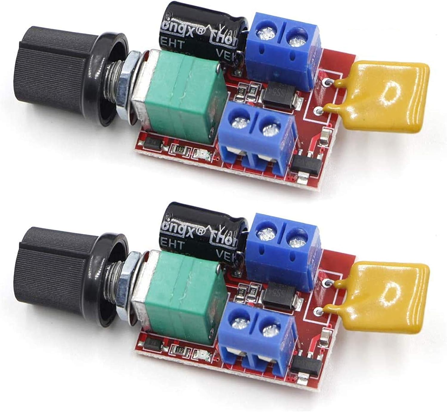

  13. smokeGTI
    smokeGTI Member
    Nov 6, 2008
    61
    27
    Hong Kong China
    I've just added a $3 cheap motor control, now I can manually control the fan from stop to full speed.
