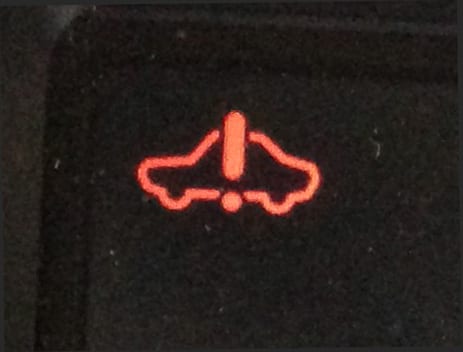

    Something's not adding up here. I've seen dozens of Gen 2 Prius with clogged battery cooling fans but never have I seen a high temperature warning light, at least not that had anything to do with the battery.
    Please post a picture of the light(s) that is coming on and ask both shops for a list of trouble codes.

    This was the warning light that came on as well as the high temperature light at other times. They were intermittent
