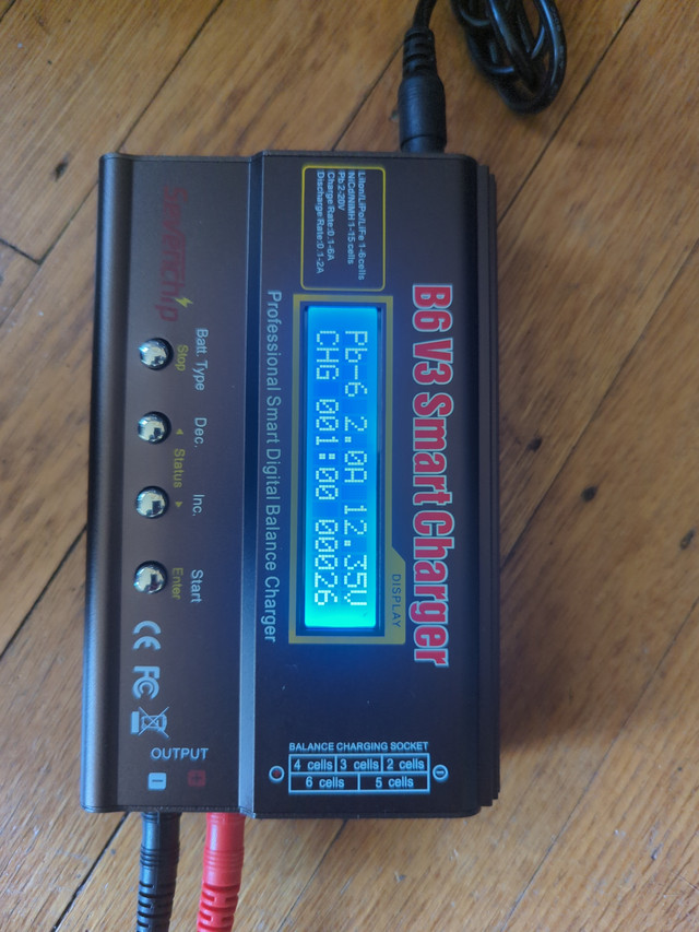

    Update on this topic. I received my "B6 V3 smart chargers" after being scammed by one Dhgate vendor. Guy sent some random bullsch*t to Salt Lake City and marked tracking as delivered. Took awhile but I got my money back:mad:.
    The chargers seem to work OK, one issue is that they don't do well charging lead/acid batteries in a car. Error message is "connection break" so I suspect its from inadequate contact. They do support NiMH cycle charging but the balance charging features are only for LiPo batteries with a special connector. I don't know enough about those systems yet to make use of the feature. So I guess I'll use the cycle charging feature with low amp discharge/charge settings. I have a car with a bad hybrid battery but haven't pulled the unit yet.

    Bought this charger, delta peak for nimh batteries seems to malfunction, mah capacity off was set to 7000 mah yet It charged my module to 9300 mah up until it started making sizzing noises(gas leak noises) and luckily I was there and noticed it. I immediately discharged all those cells but damage was likely done, how much is hard to tell. Does your unit function properly?

    Gaah sorry to hear that, and good job avoiding a disaster! My chargers are a little wonky too. I am having the "Connection Break" error message a lot. According to some guys on YouTube, I may need to replace a MOSFET on the board. Not looking forward to it. In the meantime, I've found that adding a load to the charging circuit lowers the chance of the error.
    Check the settings on the charger carefully, there is a "auto shutoff capacity(something like that?)" setting that may help with your problem?

    Oh I see you set max off to 7Ah, that's a problem! Maybe mess around with a spare cell and try different shutoff values?
