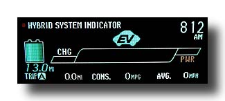

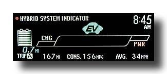

  9. john1701a
    john1701a Prius Guru
    Jan 6, 2004
    12,840
    5,312
    The above 2 examples are both EV mode. Notice there's only an "EV" symbol. There's an estimated range displayed too.
    The example below is HV mode, where both the "EV" and "ECO" symbol are available. No range means exactly that, driving is like a regular (no plug) Prius. When the "EV" symbol illuminates, that is an indication of the engine stopped (0 RPM).
