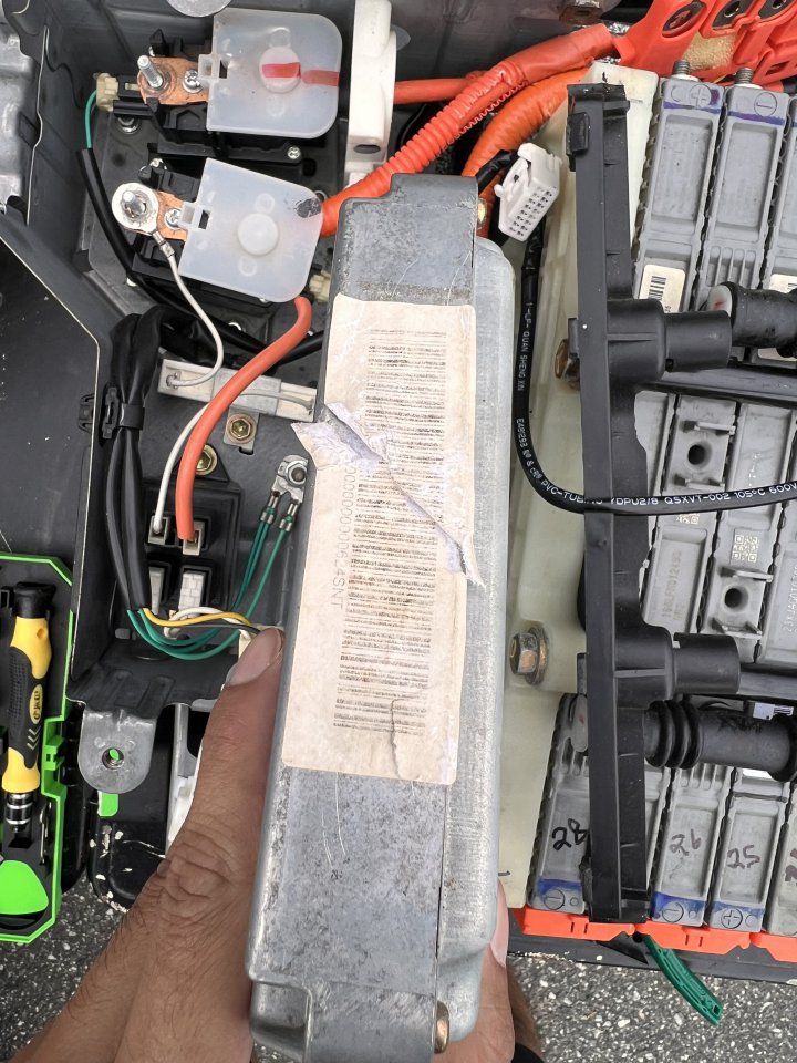

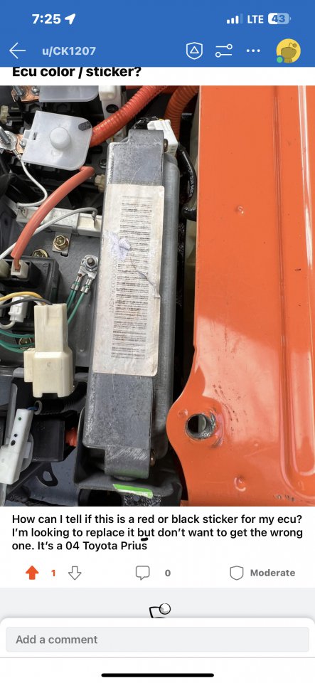

    How can I tell if this is a red or black sticker for my ecu?
    I'm looking to replace it but don't want to get the wrong one. It's a 04 Toyota Prius

    That's not the sticker you're looking for You're looking for the denso sticker which is short for nippon denso Toyota's electrical manufacturer as far as I know that thing comes with a red and the lighter model is the black I think sticker flips the ECU around on the other edge and you'll see the sticker on the end It is a foil sticker You see many of them throughout the car on many other electrical items including the yellow SRS plugs and electronics and what have you.

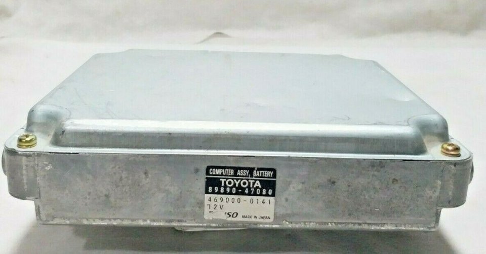

    Battery control module for 2004 prius will look like this (2004 - mid-2006)
    Green sticker - mid-2006 - mid-2008
    Red sticker - mid-2008 - 2009
    You can use any of those battery control modules on your prius and they will work but 2006 thru 2009 have software with a different algorithm than 2004.

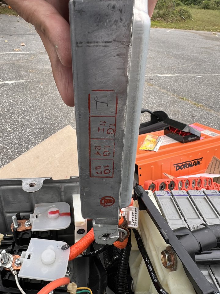

    your thoughts?? Didn’t have the usual red / black sticker

    Well I'm in the same state you are and on one side of that thing you're going to find you should find a blue or red foil sticker like everybody else is posted here so somebody scraped it off whatever Don't have a clue It didn't not come with one especially in North Carolina but I mean in any federal bill vehicle. And if it's been removed it's been done by somebody working messing around in there something.
