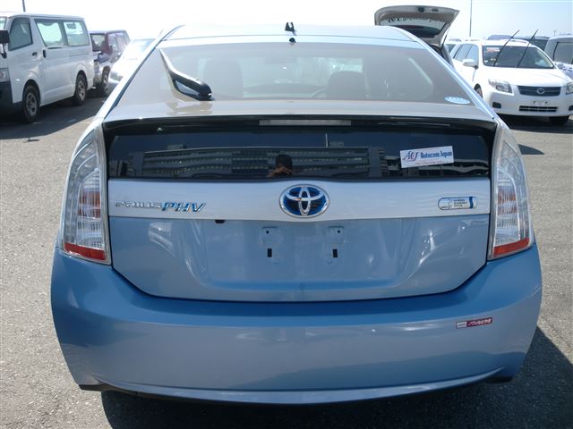

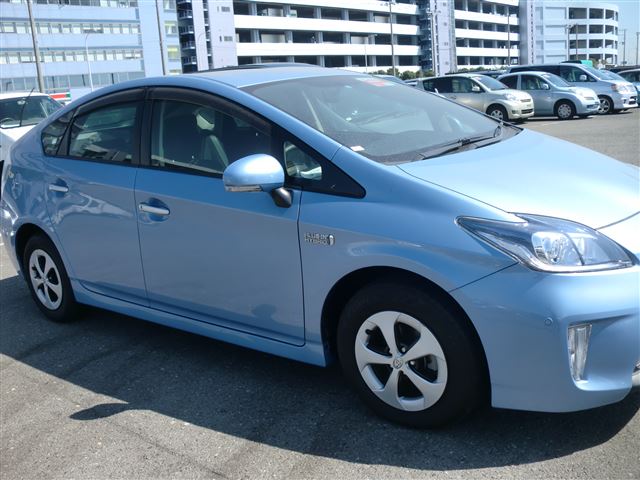

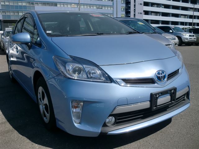

    Here are few stock pictures. Will post fresh in due course. Not sure if these would take a lot of space on the thread.

  12. bisco
    112,112
    51,016
    beautiful, but i think you flipped the negative, the steering wheel's on the wrong side!:X3:

  18. bisco
    112,112
    51,016
    you got the best color too, and i love the PHV on the hatch, i wish mine had that!(y)
