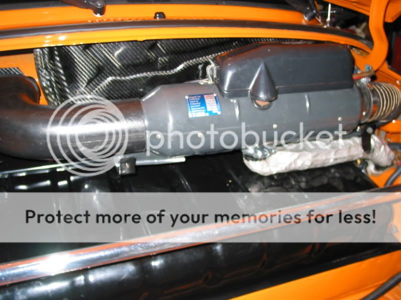

    That's the one with a gasoline heater in the "frunk" to provide cabin heat. I remember those.

    Hey, no waste heat there, just frozen buns.;)

    I've owned several aircooled VWs, some with the auxiliary gasoline heaters. Those heaters were amazing! Flick the switch and whoosh! hot air out the vent instantly.
    Yes, it burnt a lot of gasoline, but it was very efficient about safely turning it into heat, and that was the whole point.
    Some of the same manufacturers currently produce similar units that rapidly heat your watercooled engine antifreeze, and the latest models can talk to the cloud and start heating the car by remote command.
