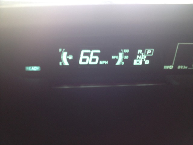

    It doesn't surprise me. My photo shows the mpg at approximately the "75" mark.
    Is there a better way to gauge mpgs at certain sustained conditions using stock instrumentation?

    Cruise control and tripometer. Reset it once you are at a specific speed. Just pay attention to what the wind and elevation are doing though.

    I can do that too. Simply get up to 70mph and back off on the accelerator a little while the speed reduces to 66mph. However, can you do that as an average mpg for 10, 20, 30 miles on flat (effectively no net elevation change) highway?

    So what I think really gave me the MPG boost was the slow Friday afternoon freeway traffic ~25-30 mph in carpool lane which allowed P&G and EV. I also live near the beach with an elevation of 11 ft above sea level, so it's a gradual decline all the way home. But as per Airstream's image -- that is exactly the MPGs that I am seeing on flat freeway at 65 mph.
