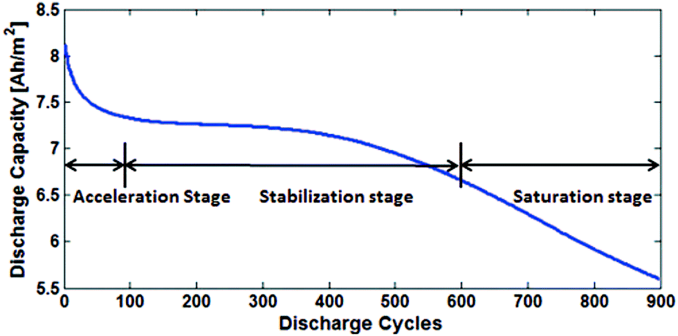

    Motor efficiency does vary, enough that engineers can optimize one of the motor units for higher speed cruising. The Lucid Air could easily have a lower power motor on one of the axles for that purpose.
    Lithium ion battery degradation: what you need to know - Physical Chemistry Chemical Physics (RSC Publishing) DOI:10.1039/D1CP00359C
    Li-ion capacity loss being quick in the beginning, before leveling off for a slow rate of loss, is well known.
    Did you track the amount of electricity being used for the charge during that time? The car systems can easily free up buffer to compensate for that early loss.

    That's a good reference.
    Well-known? I am not sure about that, but it is poorly understand if you read the article.
    Moreover, the charge rate, temperature, etc. will greatly modify the shape of this curve. Battery chemistry and construction will greatly affect it, too.
    It looks like there are two main factors degrading the battery—solid–electrolyte interface (SEI) and lithium-metal plating on the anode. The trends in the curve are because how these two phenomena interact with each other. Fast charging will in particular speed up lithium-metal plating, which is caused by the lithium ions being pushed too fast into the anode lattice and not finding their way inside but plating on the surface.

    Jeez - so fight the obvious - regardless of chemistry, different graphs from different time frames show a pattern of decline faster towards the beginning. lol - ya try & help ....

    What you quoted from me has nothing to do with the shape of the curve. I was talking about life expectancy of different chemistries.
    Moreover, the shape of the curve depends on the charging rate and other factors, and there is nothing obvious about it.
