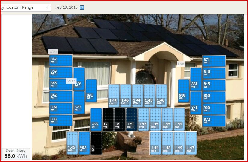

    This is a screen shot of my home PV system on Feb 13, 2015
    as you can see, I'm able to monitor PV production at any given moment.
    In the picture, the lower very dark an low number panels, are caked with ice/snow since a few days and providing minimal energy. The others are not suffering major shading and still making great amount of PV energy. You will not have the same result with string systems.
    I do not know where your information comes from but Enphase energy had manufactured OVER 5 Millions microinverters until 4 quarter of 2014.
    I think it is a proven product.
    You paid more overall for the installation, but you surely get a better equipment performance and monitoring.
    Now, in you geographical location, heat is an issue with many electronics; it is possible that may be more claims for microinverters out of tolerance due to outdoor temperature than in the NE of the USA.
