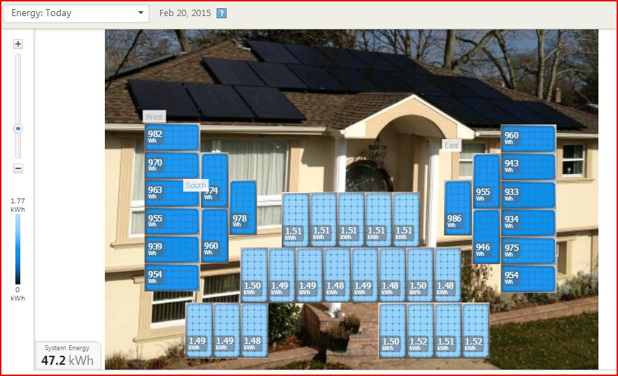

    My location problem is my primary roof surface ridgeline runs from N-S which means half of my roof faces due East and the other half faces due West. No Southern exposure, so from sun up till mid afternoon the East facing roof gets full sun then shading after that and the West facing roof gets full sun after maybe 10am till sunset. So it's a bit of a complex setup.... I wonder what kind of output I'd get out of a split setup like that? IIRC- I calculated I can fit 13 panels on each side of the roof for a total of 26 panels total. I do have one small South facing roof that could probably take 4-5 panels if that makes a difference too.

    This is a screen shot of today PV energy production, cold, very cold but mostly bright.
    You will be able to assess in real circumstances what to expect from East-South-West exposures with not shading
