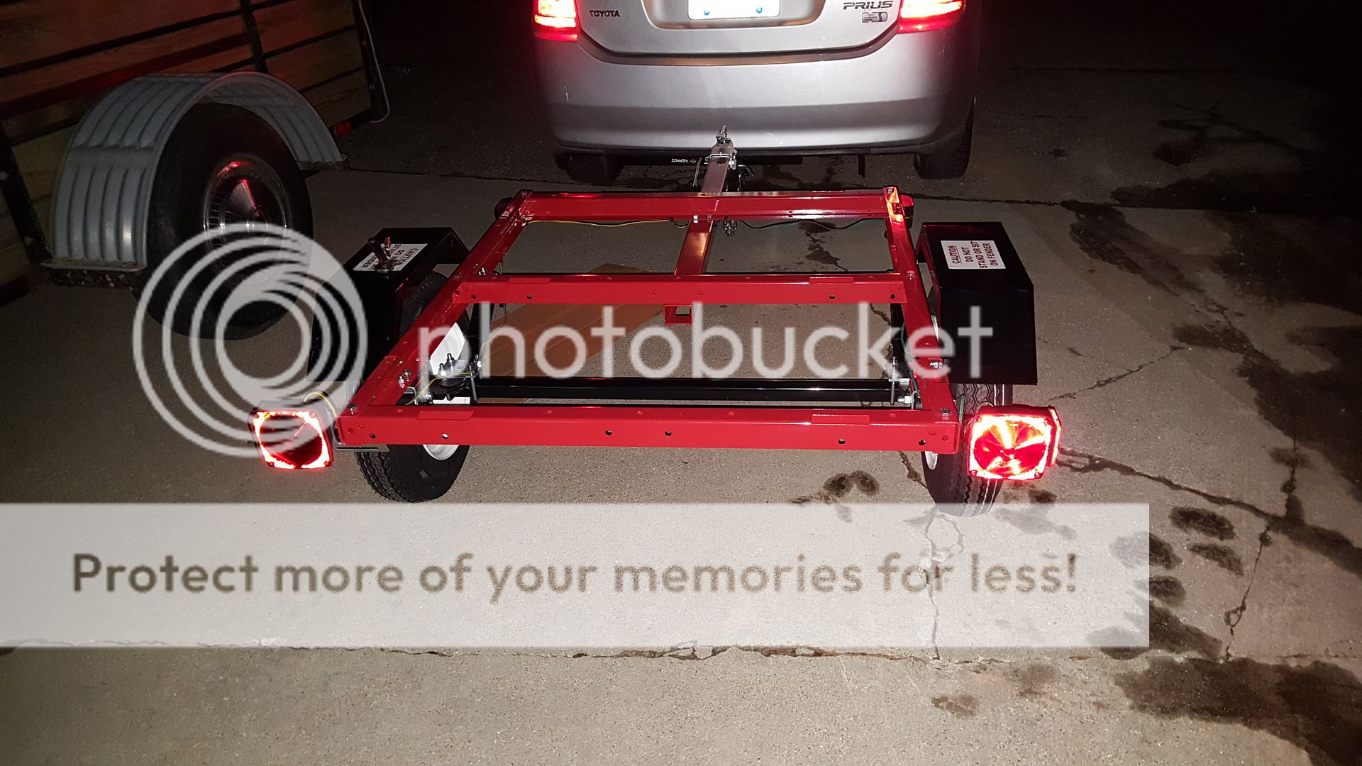

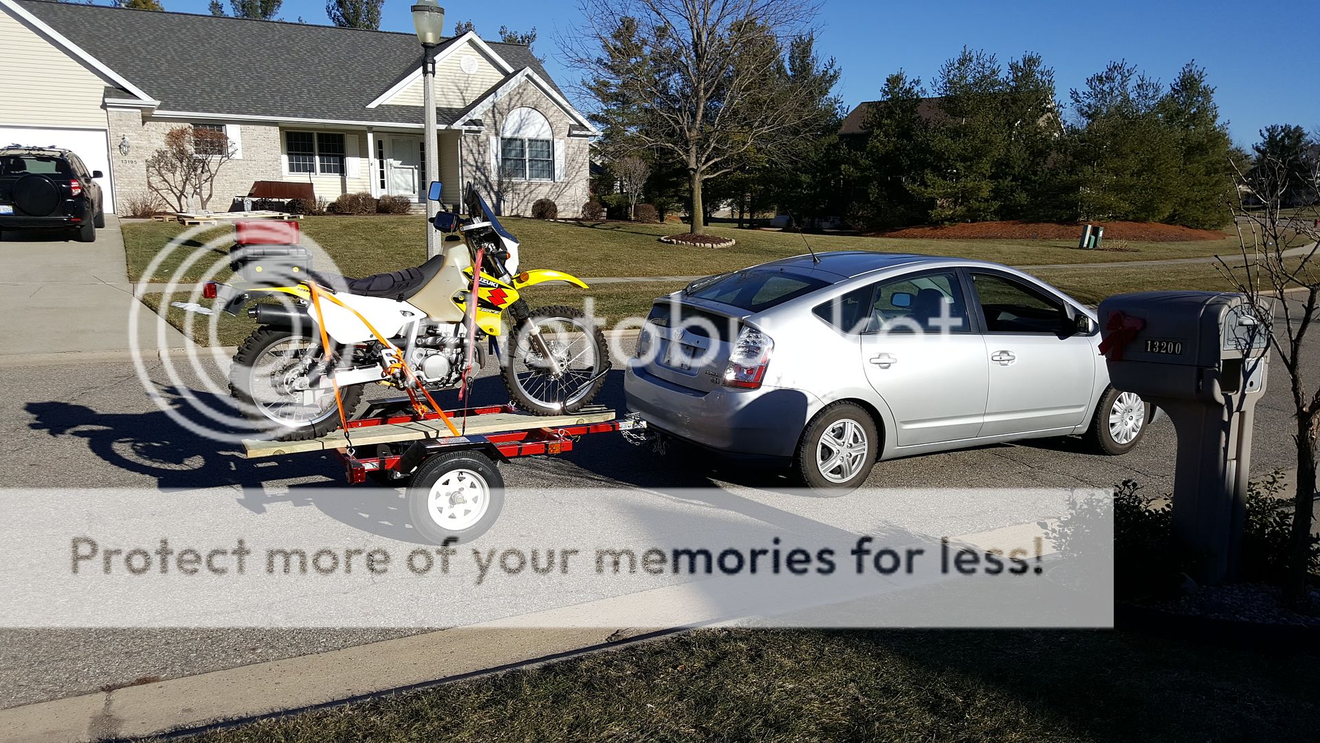

    I got the 42" X 48" HF trailer. Its listed for $238. I had a 20% discount that clearly states that the coupon cannot be used be a trailer or generator, etc. I cried foul and the Manager used a store 20% Customer Satisfaction Coupon that gave me 20% off the entire receipt not just one item.
    I like this trailer a lot--use real Mobil 1 synthetic bearing grease and also use Loctite for all the fasteners Make sure your rail for your bike (I used wood) goes all the way to the front of the tongue. Make sure you get a hitch tightener otherwise you will hear rattling.
    I got the hitch and wiring harness from Amazon. I saw the youtube video installation from etrailer.com for both the hitch and the wiring. I am not mechanical and I had everything done in 2 hours.
    I took it for a long 30 Miles shakedown test today. No issues at any speeds up to 72 MPH. I also took it on some dirt (farm gravel roads) and the car, trailer and bike did well.
    Simba
    I had a simple grounding issue that is why the left rear light/turn signal was dim. Make sure you have a decent ground connection. Use a drill to 'chip' off a little paint off the trailer.

    thanks for the help. By the way, nice DRZ, I've got a dr650 in the garage
