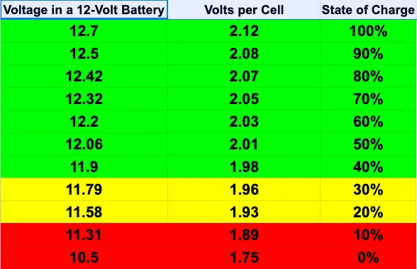

  12. Mr.Vanvandenburg
    Mar 15, 2007
    1,320
    540
    2020 Prius Prime
    Don’t know. This guy talks about it more than I want to read about it. It’s about right, close enough for a car owner to know when to charge.
    I avoid all of it and I can read what I need to know from my battery monitor in real time, plus a graph, on my cell phone. It shows voltage differences when the car is doing different things as I drive, or when car is off.
    It’s like the multimeter is a wagon, and I have a Tesla.
    https://modernsurvivalblog.com/alternative-energy/battery-state-of-charge-chart/#:~:text=The%20%E2%80%98State%20Of%20Charge%E2%80%99%20%28SOC%29%20of,you%20need%20to%20know%20its%20condition.&text=The%20%E2%80%98State%20Of%20Charge%E2%80%99,to%20know%20its%20condition.&text=Of%20Charge%E2%80%99%20%28SOC%29%20of,you%20need%20to%20know
