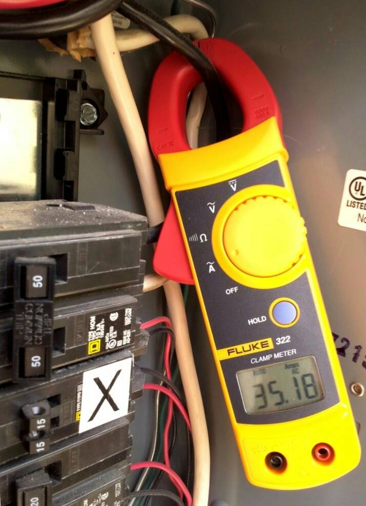

    no - cooling batteries with just air is potentially a greater heat danger. 6Kw does NOT create a lot of heat in & of itself. VW/Audi is in the process of setting up 300+ mile EV infrastructure with 600V - 15 min - 80% recharge times. Even teslas recharge @ 120kW's - so claiming 6kW's is fast can only remotely
    be considered 'moderate' if it's compared to 120V - 1kW charging. It's just that charging & discharging at high rates while being encased w/in confined areas necessitates a more expensive / complex thermal management design. Heck - our home's AC pulls ~25% more than 6kW's.
    But a residential AC isn't so confined - and has a mongo noisy fan that moves huge amounts of (hot) air. Not the same as a confined battery traveling across a hot desert, but electric appliance / thermal conditions have similar issues to overcome-deal with.

    I am not exactly sure what your point is. You say air cooling is dangerous, and yet that is how the Prius cools the battery. You also say that 6kwh does not create a lot of heat. To get that 6kwh, you have to put in 8kwh. 2kwh turns into heat. Put a 2 kw electric heater in the trunk of your Prius and run it for an hour. Actually, don't. Too dangerous. That is what the 4 inches is for. I am not sure what your home A/C has to do with the battery heat. A liquid cooled system would be a lot more efficient, but the technical issues and higher cost make it currently impractical.

    again - no i didn't say that either. The statement referred to amounts of heat in relation to the minimum & maximum that electric cars charge. Heat generated via electricity turns on how much is passing through whatever gauge wire & the appliances ability to handle it. So that whole notion is somewhat of a tangent.
    i'm sorry but if you have 220V & multiply the typical 30 amps that gets drawn by a J1772 you get 6.6kWh. If you presume the prius draws 8kW's just to get 6, that would mean the charger has an efficiency of less than 80% - in stead of over 95% & NO EVSE is that inefficient.
