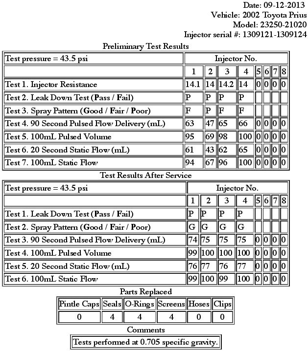

    Here are the test results for astrolink's old injectors:
    Unlike the ones from my car that I tested in May, these had plenty of room for improvement from before to after cleaning, as you'd expect given astrolink's noticeable rough running.
    It seems they had two kinds of problem: (1) the average delivery for the set of 4 was reduced by about 20% on the 90-second pulsed test, 25% on the 20-second static test, with ±20% reportedly being the trim range the ECU is able to learn, and (2) there was a 31-33% imbalance between the best and the very bad injector #2. Two observations:
    • The in-tank injector cleaner that astrolink had run two cans of wasn't effective.
    • The reconditioning service was.
    That seems to confirm the results reported here.
    The test results after servicing for these injectors are just as good as the ones I sent in May. Rich has fitted them with new screens, seals, and O-rings, and scribed them with serial numbers matching them to the test results above.
    Anyone who can use a well-balanced set of restored injectors, PM me. My cost was $83.60; cover that plus postage from me to you and they're yours.
    -Chap
