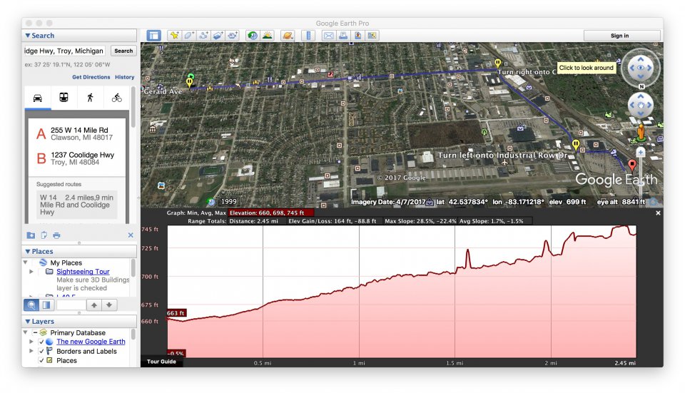

    Google earth has the ability to plot the altitude differences. I don't want to compromise your home and work locations but you could 'crop' a screen shot to share just the elevation changes. The reason I bring this up is Huntsville is in the Tennessee valley and we have steep ridges within a mile of our home. Tonight's forecast is freezing temperatures at dawn, a good time to try and replicate your symptom.

    Ok here's the screenshot @bwilson4web has compiled

    So a one hundred foot elevation from home to work results in ICE kicking in?:confused:

    I'll try this route Saturday morning at dawn:

    the immediate hill climb in post #467 might be the problem. do you have another direction you can take to see if the engine starts?
    for reference, i have one direction that starts my pip engine when it's below 35 degrees, but any other direction, and it doesn't.
    also, if i drive a mile on the flat, if i then go the direction that usually starts it, it doesn't start.

    @bwilson4web can you map out my elevation going east on 14 mile road for about 2 to 3 miles?

    I asked @bwilson4web to map out going east on 14 mile road, didn't get a response back so I tried it. I mapped out 255 west 14 mile road Clawson Michigan to dequindre and 14 mile road. Couldn't get the elevation map to show up but was able to mouse over the path and see the elevation readouts and it looks like it's going downhill. anyway, I went east on 14 mile road 45 minutes ago and ICE kicked in.:rolleyes: 36 F
