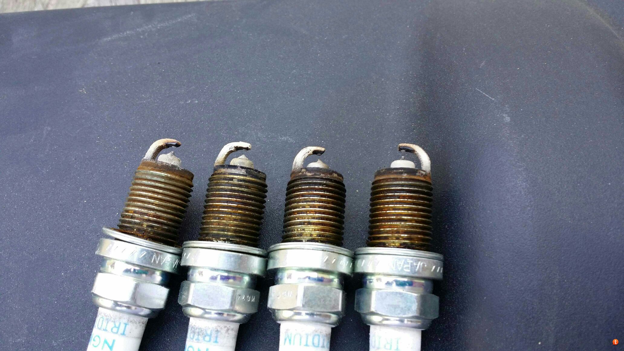

    I just pulled the spark plugs, previous owner told me they were replaced at 100k, but they looked caked with carbon deposits. It's only be 20k since. This has nothing to do with my reported problem

    With that mystery solved, I have to find out why those darn spark plugs look so ugly and caked with carbon.

    Not sure they look too bad without a more close up image, they seem fairly comparable to these: Spark Plug pictures after 120,631 miles | PriusChat
    Remember that the fuzzy grey coating doesn't always just build up. I think it's more like an equilibrium condition between deposit breakdown/removal and build up. They'll probably look worse if the last thousand miles have been lots of short trips and cold engine, and better if it's been more longer trips and highway cruising.

    The plugs have lots of thick carbon deposits on them. The previous owner drove 1 mile to work and then back. Engine probably didn't get hot enough to burn off the carbon. The plugs look worst than the plugs off my 08 at 120k miles, these plugs only have 20k on them.
