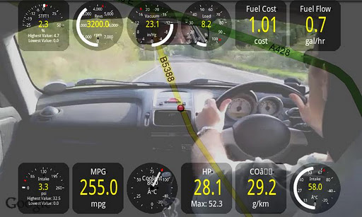

    I just got mine BT adapter & Torque app. It's great, but there is definitely still some usefulness from the having a ScanGauge.
    What I'm really bummed about is the lack of an export feature for the instrument overlay in the video recorder. Then it would be a killer app. Just think what I could provide for Prius info with that.

    I think there's a plug-in for that, isnt there? On their demo videos, they show the gauge over lays and even google map overlays, if I recall correctly.
    I havent tried it myself since my 4+ year old Android device belongs in the junkyard
    Here it is:
    Track Recorder(Torque OBD/Car) - Android Apps on Google Play
    sample:
    lensovet likes this.

    Looking at the reviews, the video export/record function is no longer available in the newer versions.
