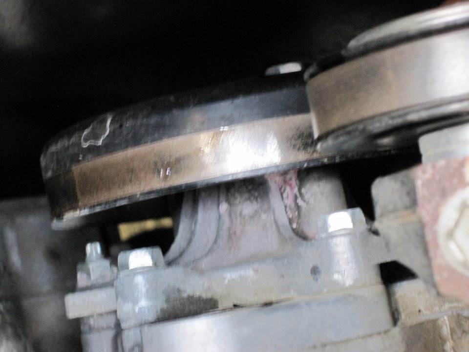

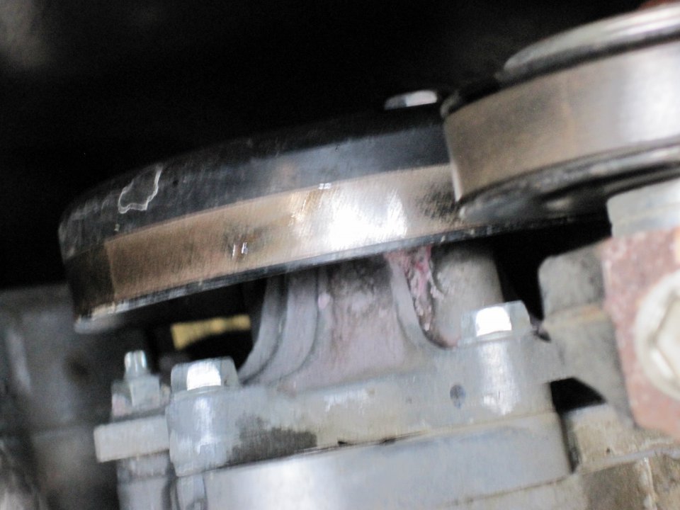

    I have attached a photo of what appears to me to be dried coolant behind the bottom pulley -- the one closest to the ground -- that the serpentine belt goes around. I looked at that spot many times in the past couple of days, but guess I missed it. To be honest, I was looking for chewed wires.
    Not sure how well you can see it in the pix, but it is pink, dried. The fresh wet droplets are fresh coolant that came off the radiator cap, which I had just taken off a minute or two before I took the picture. Any chance that this caused all this...

    that's the Engine Water Pump that looks like it could use a replacement. I'm not sure of its possible connection to the codes though.

    I would replace the engine coolant pump for sure. There is zero chance this caused your issue or those codes.

    1. Replace the engine coolant pump at your earliest convenience, but that was not the cause of the engine no-start issue

    A tiny portion of the serpentine belt can be seen in the upper right photo, as it wraps around the idler pulley. The belt does not run all the way around the engine coolant pump pulley. Rather only a portion of the pulley is contacted by the belt.
