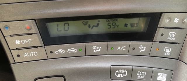

    Rebound, I tried this this morning. No luck again. My car is garaged, it was 50 outside when I headed out, cabin temp was set as low as it could go - the "Low" setting, but the ICE still kicked in. In the fall to winter here, just north of Sacto, we often get am commute temps as low as the 30-40s. In the Bay Area, your temps are probably more moderate.
    I may have to go the Fog-X or Windshield Wonder route that some have considered here.

    Maybe you pressed the Front Defrost button? Here's a pic of my settings:
    iplug likes this.

    You're right, I did have the front defroster button on today. I did not read all the posts on the other thread. I'll give this another shot tomorrow morning. I could bear with the cold cabin AC if it can clear the windows up in a few seconds like the front defroster setting. My daily commute is only a few miles so it really makes sense to stay in EV mode, otherwise it would be nearly the same as just driving a standard Prius in the winter.
