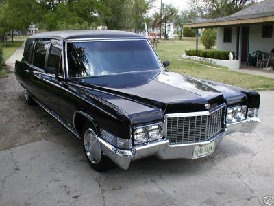

    I found a '70 Superior coach (ambulance I think) in some local classifieds, for $800, has 52k on a caddy 500. I talked to a guy at a local customs/performance shop, and he thinks my best bet would be to put a dual exhaust system (some dummy put a single catalyst system on it, this is not required in texas, so I'm gunna chop it off) and some form of fuel injection. friend at salvage yard has some nice leather seats to put in the back, as well as a 700R4 transmission. all my sources say that I will be able to get 15 highway, which is what I get in my Ford, but this is cheap unleaded (have to use octane booster and a lead additive) so it will be about the same cost per mile as the truck. it also has a 45 gallon tank, same as my truck. I haven't gone to look at it yet, but I think this is the way to go. MPG's were last on my priority list anyway.
    probably looks like this:

    Bought the Superior.
    6 MPG is a gross overstatement, it was stolen in 1974 (who the **** steals a hearse?) and the original drivetrain was pulled. the car was recovered, and an OEM engine was put in, but this being 1977, the emissions regulations were very harsh on the car-so a 1976 caddy 500 was put in (185 hp?) with smogged heads, smog pump, and a single exhaust with a catalyst was installed, with a hydro-something trans out of a '62 oldsmobile, (2 speed) and the diff was out of a '72 GMC heavy truck of some kind-meaning my RPMs redline at 75 miles per.
    I paid $500 for it.
    it started after a little tinkering, fresh gas and a carb tune. my friend at the salvage yard has some older (better) heads to put on it, along with a 700R4 trans, and a higher ring gear for the diff (2.10s, he thinks) with the .68 OD, through 2.10s on 16 inch tires, my final drive should be 1.482, which is good for towing on the higway, its also a posi, so plenty of grip on gravel roads, and for towing in mud.
    no pictures, as my phone took a swim a week ago, but it looks a lot like this. paint is good, interior leather is better. its a new car. its stupid big to drive, but handles nicely, because of the long wheelbase and its very low center of gravity. once the engine isn't scaring the shit out of me with its revs, I think I will love this thing. but 2 miles a gallon highway is retarded.
    all things considered, the car will run me $2800 or so, ready for work. tomorrow, a whole bunch of co-workers and friends are going with me to the salvage yard so this thing will be ready for service.
    if you are ever in central/west texas, and see a Cadillac hearse towing an oil derrick, you will immediately know its me, and I am content with my unique, new car.
