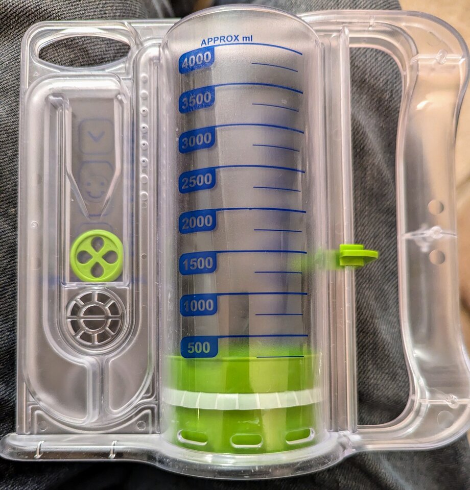

    A family member has been presented with an incentive spirometer, to use in training for an upcoming procedure.
    It has both a small 'indicator' for air flow rate, and a piston that rises in a cylinder marked off to 4000 ml of air volume.
    The idea is you shoot for inhaling at a pretty constant flow rate (keeping the 'indicator' near the middle of its travel), and see the total volume you have inhaled from how high the piston rises.
    What seems nifty to me about it is the graduated cylinder is nowhere near 4 liters in size! That would be like gallon-jug sized. This is sized more like a drinking glass. I might guess more on the order of 0.4 l, or a tenth of the indicated volume.
    So I'm thinking this gizmo must have some kind of clever proportioning valve that's letting 9/10 of the air you inhale come in directly, while 1/10 is drawn from the cylinder above the piston.
    I'm no fluid dynamics guy, but I'd guess it's hard to build such a proportioning valve (especially a cheap and disposable one) and have it be accurate over much of a range of flow rate. Of course, the problem here is simpler, because there's already the flow indicator and part of the game is you try to inhale at a constant rate in the middle of the range. So maybe a proportioning valve that's kinda accurate at that target rate is 'good enough'.
    Makes me wonder how far off the volume measurement might be at higher or lower flow rates than the target.
    I did a brief search this morning for "incentive spirometer patent" and found several patents on other aspects of designing the things, but still haven't found anything for "here's how we got away with a graduated cylinder that's way smaller than the actual volume being measured".
    Edit: or is the trick just that at the targeted flow rate, you're sucking with an absolute pressure near 1/10th atmospheric, and the volume is marked off for standard pressure? My gut tells me that 1/10th atmospheric would feel like a really hard suck, though, and the target rate feels like taking a pretty easy breath.

    ^ That's it. Truly not that accurate but gives them a ball-park assessment and something to write down onto the charts. Can you imagine someone putting, a smidge, about half-way or one-third in your charts? Those things are all built to an engineering specification so they all ball-park in the general area. Besides air is difficult to quantify biased on Boyle's + Charle's gas laws.
    Medical staff is looking for rate of change - are you getting better or worse? A baseline must be set. That unit is measuring a single breath, we're usually looking at LPM (liters per minute) - so normal breathing is around 8-12 BPM (breaths per minute) in an adult. So that's why that cylinder is measuring an average of 1/10. During baseline assessment (ie. hospital check-in); there's a spot in your records of how many BPM, establishing your normal.

    No proportioning valve on the one I saw. There is a piston adding resistance. The device is $10.
    It is more breathing exercise with feedback. You are instructed to give it your all. Often needed after a long total anesthetic procedure.

    Somehow, though, the idea is that the marks on the grad cylinder do tell you how much air you inhaled ... and when it tells me I've inhaled 3 l of air, I really do feel like I've inhaled 3 l of air, even though I can't have gotten more than 0.3 l from the cylinder above that piston.
    And the more I think about my later idea (am I just sucking it down to 1/10 pressure?), the more implausible that sounds. If I could do that, I could suck water up a three-storey straw. I don't think so. (Just think of the possibilities for hickies though.)

    Toward the left, you can see three small circles stacked up: the green flow-indicating disk sitting at the bottom of its vertical channel; below that, a round air-inlet grille; below that (seen through the translucent plastic) the round mouthpiece you inhale from, on the 'back' side in this photo.
    You can see a molded passage running from the top of the flow-indicator channel, down the left side, ending at the mouthpiece, and a smaller channel to the right of the mouthpiece leading from the top of the graduated volume cylinder.
    So as you inhale, most of the air you're inhaling is coming in through the round grille and the flow meter, and a smaller fraction is coming out of the graduated cylinder and lifting the piston. The cylinder still looks to me like maybe a tenth of the marked-off volume, so you're inhaling 9/10 through the flow-meter inlet and 1/10 from the cylinder.
    The little passage from the cylinder to the mouthpiece shows eight little plastic bosses, the middle four having holes drilled through. I'm guessing that's how it's calibrated at the factory: build it to read higher than the true amount with none of the bosses drilled, attach it to a calibrated 'inhaler', then drill tiny leaks into as many of those eight bosses as it takes to get acceptable accuracy.
    I'm pretty convinced now that the volume reading's accuracy must be pretty dependent on you inhaling at the right rate to keep the green disk at the target middle position, add will be in error by larger amounts the more your inhaling rate differs from the target.
    I'm also pretty sure if you hold it so once of your fingertips 'accidentally' blocks part of that inlet grille on the back, you could astound your respiratory therapist with your stupendous lung capacity.

    As rjparker summarized well in #3, the incentive spirometer (the name also gives it away) really exists as a way to gamify deep breathing, so that a person recovering from a procedure doesn't forget to do it, and suffer complications.
    Other devices and techniques mentioned above are useful in their own right for improving other aspects of performance.
    I just thought it was pretty clever (and I still do) how they built a device that could measure up to a four-liter volume without being nearly four liters in size, and disposable with a $10 price point.
