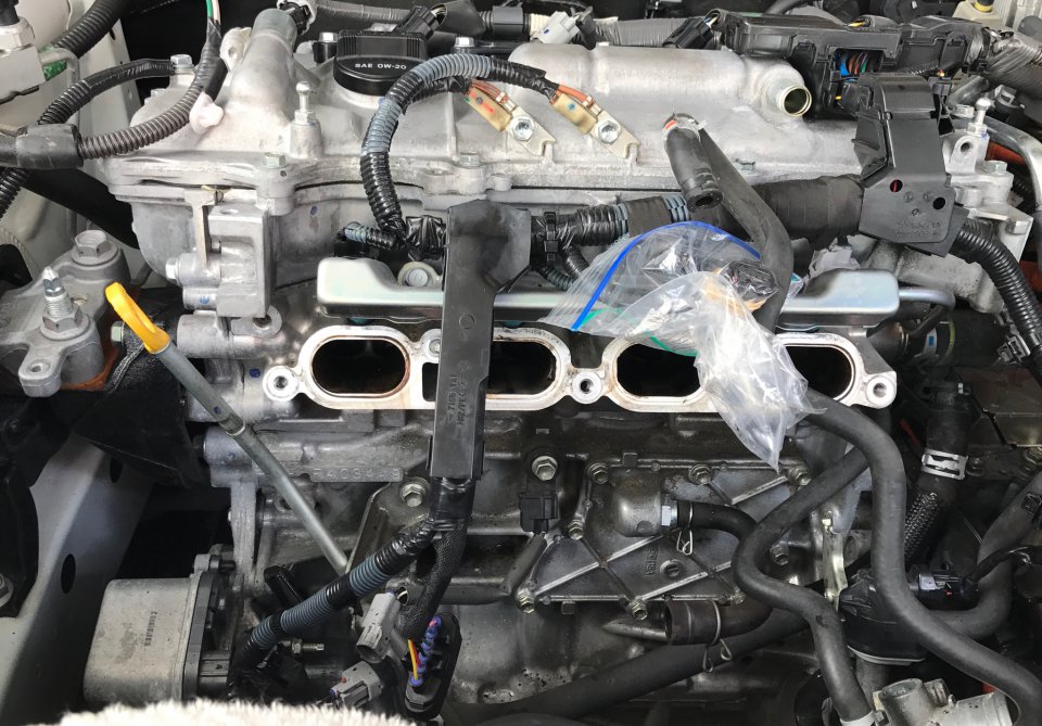

    Here's a picture that shows where the valves are. You can see the valve stems at the back of the intake:
    An2TheTwan likes this.
