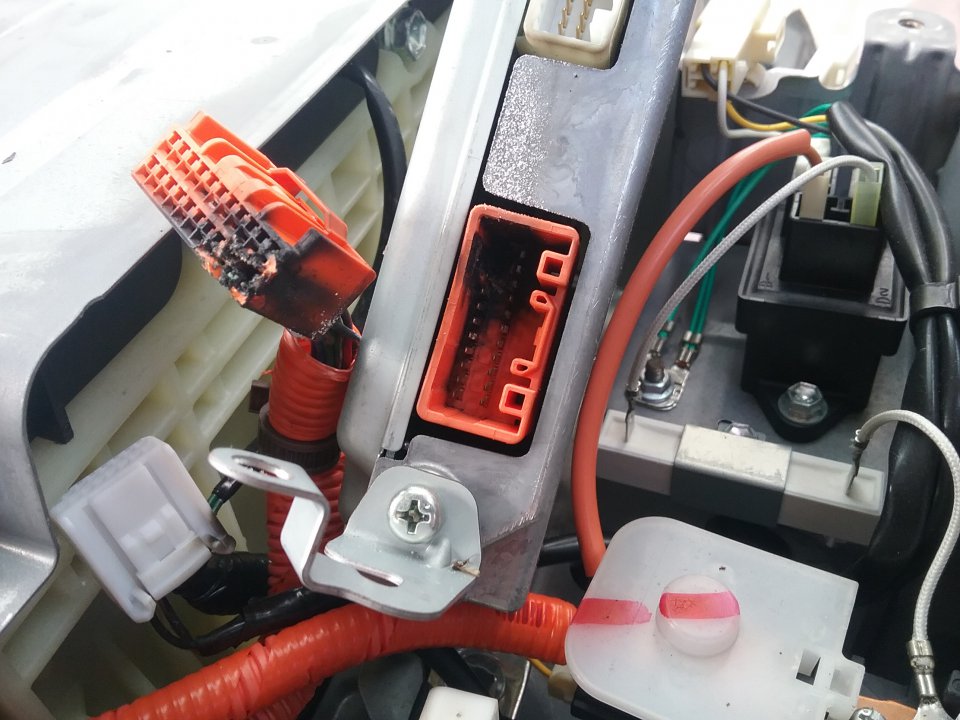

    If you feel like digging in, have a look at the HV battery ECU and sensing cable for corrosion :
    If you see nothing there, then pop the lid on the battery and take a quick look inside.
