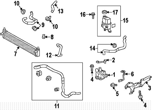

    I've reviewed the diagrams of both the ICE and inverter coooling system parts. They are posted here as attachments.
    It appears that the complicated "thermos" and related pump system has been eliminated.
    The radiator of the ICE circuit is drained with the radiator drain plug on the tank on the back o the radiator on the diver's side. As I recall, the engine cooling drain is on the passenger side of the engine behind the area of the front axle.
    I don't know if there is a drain on the inverter houing. If NOT, the circuit can easily be drained by removing one end of the lowest situated hose like on many current GM vehicles without a radiaor petcock.
    I own both he Lisle 24610 radiator fill funel;
    Lisle 24610 Spill-Free Funnel : Amazon.com : Automotive
    and the UView 550000 Airlift system;
    UView 550000 Airlift Cooling System Leak Checker and Airlock Purge Tool Kit : Amazon.com : Automotive
    I have not tried either on the Gen III Prius but have sed them on other vehicles.
    I am hoping that either or both will work.
    edthefox5 and frodoz737 like this.

    Oh no more thermos on Gen III? Cool...then with a Uview that should be a snap. I tried using my Uview on my Gen II and did not work well at all.
    Btw, with its own separate Inverter cooler not body connected to the rad like a Gen II what kind of temps do you see on the Inverter system? I always thought if the cooler was not bolted to the rad (heat soaking it) it would run much cooler making the Inverter much more efficient=better gas mileage.
    Thank you for the gif's.

    I looked under the hood of my Prius and found that the components are at four different levels.
    The reservoir is at the highest point.
    The inverter is below the resevoir, but at a point higher than the pump.
    Finally, the cooler is at the lowest point.
    I haven't removed the front lower underpanel, but there might be a drain plug on the cooler.

    If my memory serves me correctly - there's a drain for the inverter coolant somewhere near the transaxle fluid drain. (I believe that the instructions for the DIY transaxle fluid change point it out as a precaution...)

    Here is some further info... this should be helpful
    frodoz737 likes this.
