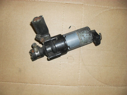

    My friend's '07 pump died today. New one costs around $140.
    guess what i did ???
    i found a Used Mercedes Sprinter 2004 Auxiliary Water Pump costing around $20, installed it myself. Removed the negative terminal of the battery for 2 min to reset the codes. And now its running great. Better than the original. Coolant is being pumped at higher speeds as compared to original prius's pump.
    Check out the pump pic. this is not the original pic though, but u can get the idea.

    I have always thought that, in this world of infinite pumps, there must be one that is better than what Toyota is offering. The safety recall on the inverter pump put off that search. I wonder what the current draw is from the new pump compared to the old.
    That said, if that car has not already had the safety recall done, you could have taken it to Toyota and they would have done it for you, free.

    Like that. Looks alot more robust than the stock pump. Very interested in temp's you see now. Do you have a IR thermometer? Take some test temps on the Inverter case and I coolant reservoir please if you can.
    IR therm is cheap at Home Depot and is a very handy tool.
    I have hypothesized the pump is under some duress based on the coolant condition. The coolant is circulated through a very large amount of tiny aluminum channels in the heat sink of the Inverter resulting in the fluid easily contaminated by aluminum by just shear wear. Aluminum is a very corrosive metal and microscopically in solution would be very abrasive. Probably very hard on the pump seals. So it behooves a Prius owner to keep fresh inverter coolant in the car. I would not go longer than 30K on that coolant. If anyone is curious suck some of your fluid out with a turkey baster into a clear jar and see how cloudy it is compared to new coolant.
    In fact its not a bad idea to suck the reservoir out and just install new SLLC. Do that a few times and that will really help.
    The Inverter coolant system protects some very expensive gear. Both the Inverter and the transmission.
    My bought new 07 was not on the Inverter pump recall and I am still running the original pump at 60,000 miles. I changed the oem fluid at 30K. Due again.
    But when the car was new I removed some of the Inverter Coolant with a turkey baster and added half a bottle of this stuff. I was after it's anti corrosion properties and have had really good luck with this stuff in my radiators over the last 20 years. It really keeps the rad clean. It's been in my Prius for 6 years now. It works.
    Red Line Synthetic Oil - WaterWetter® Coolant Additives - WaterWetter®
