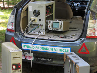

    Here's hobbit testing one of Randy's earlier 3000W offerings, after removing the casters from the bottom to reduce the height a bit.

    Randy's setup pic shook me well :confused:. Is that what it takes to do 220VDC to 110V AC, nothing else smaller?
