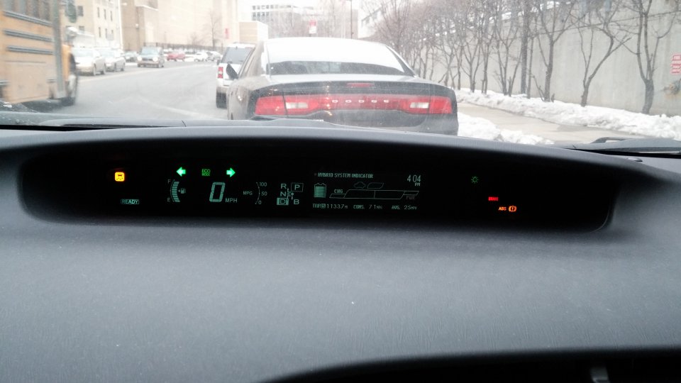

    I took a pic. I have all the warning lights in that doc. I am not sure where the Check Hybrid System message is shown. If it is on the LCD screen, I did not take pic of it. I may have missed it.

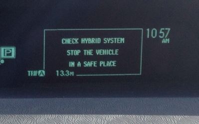

    Here's what the Check Hybrid System message looks like
    If I recall, there was a long single tone beep and that message appears, then the other lights lit up for me. Later in the day, when this picture was taken, the other lights were gone, except for the CEL triangle and this message on the LCD. In my case though, after removing the ODB2 adapter, the message and lights all went away (and have not returned since).
    But hopefully your visit to the dealer will determine if something actually happened or not.
