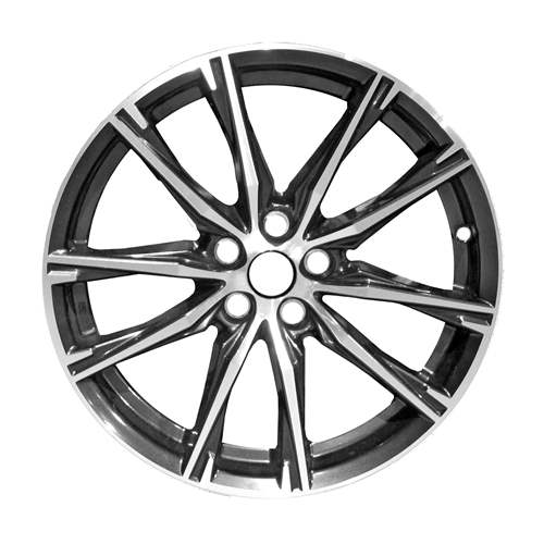

    If OP is still interested, I'm about to replace the stock OEM + Hubcap combination on my recently acquired 2018 Four with 2018 BRZ wheels. They have the same lug spacing and default tire size as the touring package [​IMG] and I'll just use a bore spacer. Pics to follow tomorrow!

    Here you go, BRZ/Toyota 86 wheels. I forgot that you have to use an 8mm spacer to get the wheels to clear the callipers. you also need to change lug nuts. prius new wheels.jpg

    Question, was 8mm the absolute minimum one could go for with spacers?
    I'm going with some 2013 BRZ/86 wheels (17x7, 5x100, +48).
    I'm hoping to get a 5mm spacer but haven't measured if that'd be enough to clear the calipers.
