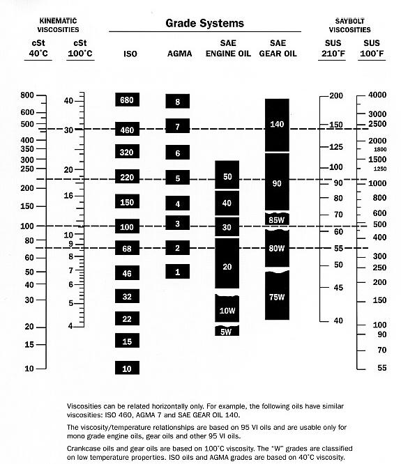

    Close but not quite. SAE viscosity standard has a range. Look it up.

    That's what the 0w-20 is, multigrade. 2 different brands of 0w-20 oil will not differ in viscosity.

    Nope. SAE 20 is 5.6-9.3 cSt @100c. This is a huge range of viscosity.

    No one is debating there is a range. But that range doesn't change in the same SAE rating from brand to brand, which is what was being discussed.

    If for example a Mobile 1 brand 0w-20 oil proves to have a different viscosity range than say the Toyota brand (or any brand) 0w-20 oil, then one of them is not within the SAE 0w-20 standard.

    And for those reading, SAE 0W-20 means it has an SAE viscosity rating of 0 in cold temperatures and a rating of 20 at normal operating temperature. Any oil which deviates from this cannot be certificated an SAE 0W-20 oil.
