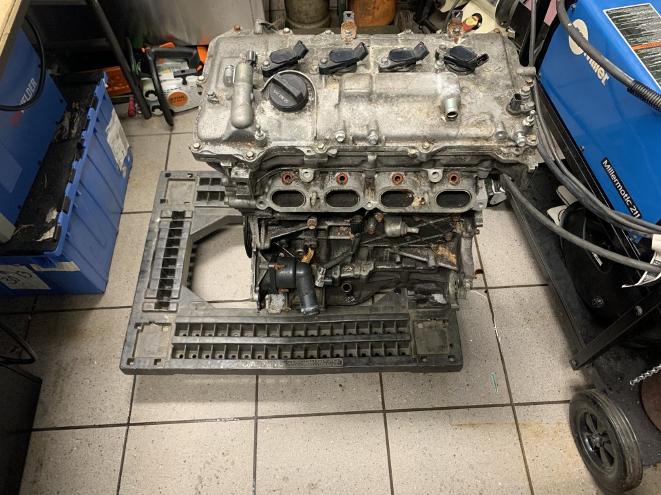

    Valve cover is off, looks very clean in there

    I
    looks super clean. is this a rebuilt?

    ^^ This motor came out of a 2013 Prius V, I pulled it out in 2021 and installed a 2017 gen 4 motor in there, I just started the process of rebuilding this one.
    This one had 140k ( I think) miles on it.
    Once I pull my old motor out of the 2010 I'll rebuild that one as well, no point chucking that one away.
    Although I can just replace the head gasket in mine and call it a day but I want to fix the oil ring issue as well, hence is why I am replacing the old one with a rebuilt unit.
