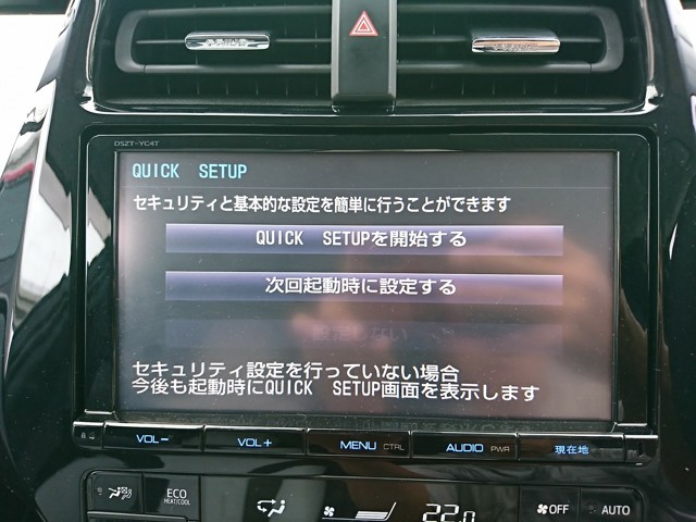

    Hi folks, welcome the newbie! Just got my first Prius... a 2016 model, imported from Japan, all the bells and whistles, 4WD, two-tone Softex, Thermotec paint etc.
    I've searched "DSZT-YC4T" both on this site, and on goggle, and I'm finding remarkably NO information on this...
    I've been to Japan several times, rented Priuses from Toyota several times over the last 3 year or so - and the rental agent has always fiddled with the radio so that menus, satnav etc. come up in English. Changed the language.
    Meet Charlotte (named by daughter!):
    Just arrived in NZ!
    And this is the radio... model DSZT-YC4T.
    And as I said, searching has produced no hint of how to change the language to English. I've been through the thing using google translate, and I stopped by a Toyota dealer who has an employee who can read enough Japanese to be dangerous, and neither of us could find a 'language' setting anywhere!
    Surprisingly NO relevant results on google for changing the language on this specific model of head unit, which I find surprising; am I truly the first to hit this problem?
    Help? Do I need to actually reprogram it - as in, install new firmware - to get English? Or it impossible and I have to get a different Toyota head unit - the one they had in rental cars in Japan, which they definitely switched to English? Thanks!

    I've poked through the settings using google translate again, and there IS a software update screen which invites you to push the button to open the screen and insert a... presumably SD card or CD... to update the software. Maybe it can be updated to a version that includes English language support? That would be something I would have to ask my Toyota dealership to look into, I suspect?
    Do you know, is there a definitive list anywhere of the various models of head unit that Toyota fitted to these cars in various markets? I mean the 'easy' way would be to locate an English language head unit from a Gen4 car from a scrapyard, but that could also be the expensive way - and NZ is a small country, so not many scrappers around.
    I would like to find what unit they put in the Toyota rental fleet in Japan... heck, it might even be the *same* unit, but with different software - they put English as an option in their rental fleet, but JDM cars for the showroom only have Japanese...
    (BTW looking through the legalese, the open-source software licensing stuff on the unit, has a lot of mentions of Aisin - I knew they made gearboxes, they're Aisin geaboxes in my Renault Avantimes, but I didn't know they made head units!)
    Thanks again, any info welcomed.

    I think this is Toyota's user manual for this model DSZT-YC4T head unit. Not sure if it is the same model as DSZT-YC4 in your car. Unfortunately, it is available only in Japanese.
    https://toyota.jp/pages/contents/prius/004_p_001/pdf/interior/navi/dop_navi/dszt-yc4t.pdf
    Searching for the manual, I found no mentioning of changing the interface language of the head unit. It has several mentions of language preference for DVD player spoken language as well as subtitles, but that is not what you are looking for. It may be impossible to change the interface language on this HU. Do you know the HU model # of the rental car you drove in Japan that had English interface?

    Those are all good points! I already got that PDF and found the same as you, nothing about language change. So yes, it may be impossible to change the language... unless I replace the software with a different version which does have an English option, which is one of the things I'm asking about!
    Unfortunately I have no idea of the model of the HU in the cars I drove in Japan, which could be switched to English. I've asked someone I know in Japan to try to go into a Toyota Rental place and find that out for me.

    Not the easiest list to extract the information you are looking for, but looking at the instruction manual page from the Toyota Japan site might give you a good idea of GPS/Navigation HU models used for each year. It is again in Japanese, but under each year, the model number of HU used for all Toyota is listed. Some models are specific to the particular model of cars, but I did not find any that is Prius specific.
    From the list of user manuals, it seems DSZT-YC4T is the only model used for 2015 Prius.

    Any advance on that? I've sat down with the very helpful service manager of the local Toyota dealership and she reckons that there may be a hidden service menu, or the Japanese rental cars are fitted with different software, or that it's possible that the Priuses I rented in Japan were newer models and had a more recent head unit than the DSZT-YC4T, which it appears was only available for one year.

    Any update on this?? My HU is also DSzt__, and struggling with japanese.. is there any way???

    Looks like it's Japanese only.
