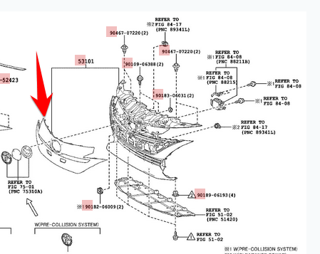

    Remember the encounter with the roadrunner in Texas back in May? I think Santa is going to bring me a new grill for a belated Christmas present. I'll know for sure after I talk some more to Todd at Tampa Hybrids later this afternoon. Looks like his price is within a couple dollars of the cheapest online price.
    The crack I got in May from the bird isn't all that bad, but this will also remove the front license stuff and clean up the whole front end. I may also put the old grill up for sale if anyone has a really busted up grill and doesn't mind having a small crack and some screw holes to mount the front license plate. Or, I wouldn't mind just keeping it in case something worse happens to this grill. I'll have to think about that.
    I found the link to a Japanese PDF that @Salamander_King posted that looks like it's sufficient for my needs. I used Google translate to convert the verbiage. (2019 Prius Prime Advanced - Front Grille Replacement | PriusChat) Thanks, SK!! If I do order the grill, I'll just wait and change the oil at the same time.

    Let us know how hard it is to change the entire sub-grill assembly. I am also interested in your assessment on whether you can just remove the acrylic portion (the part you cracked, also shown in the diagram in my quote below) without removing the rest of the front grille and bumper cover. If the acrylic part alone can be removed easily, I am thinking of taking mine off and wrapping it or plastidip painting it. Trying to wrap or paint that part while on the car is rather difficult.

    My plan at the moment is to remove the whole front as it says in the PDF you linked in the other thread. Then I can see if it can be removed from the rest of the bumper/grill assembly. I do know that the acrylic and the flat black below it come free from the painted part.
    We'll know more once I have the part in hand.

    The part number for the smoked-acrylic piece seems to be:
    5310147050
    Amayama shows it a best price of #335.38 (CDN) for me, on westcoast Canada. I've done 3 orders through them, and so far been very good, shipping costs $10~35, depending on size/weight of item:
    Buy radiator grille for Toyota Prius PHV ZVW52 (02.2017 - present) - Amayama
    Putting the above part number in a shopping cart, it doesn't show a shipping cost, maybe concerns about fragility? Shipping indicates "not selected", and if you click on that, this pops up:
    I don't believe you would be on the hook if the shipping provided exorbitant. The process usually takes about 6 days, from ordered to shipped, and you can message them, get prompt response.
    Man, would it be possible for someone to "scan" that piece, start reproducing it in more malleable and durable opaque mat-black material? As designed, it's the proverbial "glass jaw"! All the front (and rear) "bumpers" are these days, but this one in spades. :mad:
    Jerry, in your shoes, I would just remove it mask it off and go over it with a can of mat-black Plasti-Dip.

    Either way once you've got the grille and headlights removed, I believe you're gonna need techstream after you get it all reassembled. Gotta love all that hardware behind the plastic.
    I haven't had hands on, so it's only second hand info, but well worth your time to investigate before you pull the front clip
    see recalibration in the shop manual and take a look see at this thread for a heads up on the sonar.
    ICS clearance sonar learning | PriusChat

    That's what I want to try. And there was at least one person who said to do that on a different thread, but never heard the result. My question is how hard it is to remove the acrylic part off from the rest of the sub-grill assembly. If it can be removed easily without cracking the parts, I may try it. But painting it without removing it first is also a viable method.

    Yeah, maybe best to just spray, without removal. See attached, lots of fun (47 pages, and that just the bare bones, likely at least double that, if you chase down all the references).

    Anyone have an estimate for the grille replacement at a body shop or two? I'm guessing it's at least 1500 and probably more at the steelers. But it should tell you a bit more about the process.
    If you decide to paint (I wouldn't) start slow and small.

    I'd be inclined to do nothing: it's a compact crack, not opening up?
    Somewhat akin to the 3rd gen drooping rear bumper: just let'r hang...

    I've been thinking about it quite a bit and decided that I'm just going with the plasitdip that @Salamander_King and @Mendel Leisk mentioned.
    I do plan to remove the grill to make sure I get good edges. The crack by itself, isn't a big deal. But I'd also like to remove the front license plate bracket. Whoever installed it just ran the screws in w/o pre-drilling. This made huge crater walls. So while I'm at it, I plan to fix that before spraying the plastidip. Also, while the crack isn't open, it is offset a little. I'd like to get to the back side and put on a splint to line it back up before applying the plastidip. I'm hoping that when I get done it'll look like it was supposed to look that way. :D
    Simply unplugging the sensor should not cause any need for recalibration any more than disconnecting the aux battery. I'll just need to make sure I don't bang it around. If it does need adjustment, I have Tecstream and will get to learn how to do that task. This will be much less expensive.
