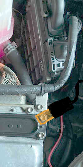

    I have used the bolt just behind the engine fuse compartment. There is no large amount of current needed like in a normal starter car; it's just control power. While this pic is Gen 2, a Gen 3 Prius is basically the same with a bolt behind the fuse box.

    Hah, was just on it:
    (the pos meter lead is connecting to the CTEK quick-connect cable I've wired in)
    Xterra72 and bisco like this.
