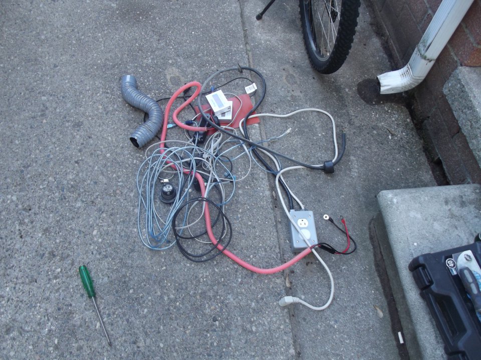

    I might as well pitch in here rather than start a new thread, look at what I got my hands on:
    I keep getting sidetracked, I had plenty on my hands allready I really did not need another project but it came available local and it was cheap enough, even got a scangage with it so what the heck.

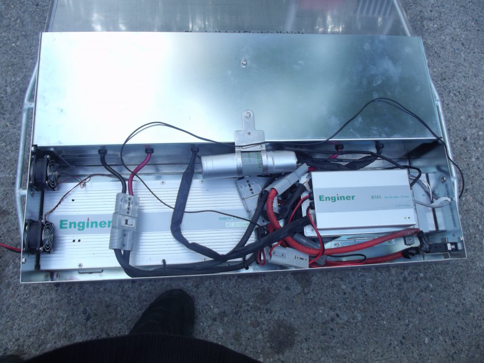

    now what exactly do I have here, it's not like I am clueless but it is a bit different than what I had seen pictures of, I was expecting those prismatic cells, it's pouches in a stainless case, I have 2 of them they are labeled 48v 80ah, maybe my math is a bit off but that is aprox 4 kw, each? the guy had it advertised as a 4 kw, he said it is highly unlikely its 8kw, he paid 3500 for it, guess those chinese labels are funny, should be 40 ah each, paralel conection I thought.
    looks like I have the 5kw converter or so it is labeled, I know the last gen mounted in the spare tire so its at least the one beforeand one of the videos I seen online with the prismatic cells had 2 rows of them 2 bms and wires everywhere, this bms has it's own box, looks like a later version I guess,
    I allready have a ev button guess I have to run the third ready wire otherwise I have 2 displays and a scangauge out of it. the power wires had a bit of a burn by the fuse, maybe I should get heavier gauge while at it, than again it would be limmited by the smallest and that 10 gauge or whatever it is comes out of the converter, I don't know how I feel about those pin plughs that connect the harness to the converter especialy with some 250v going throu it, he was running it at almoast 9 amps, we ran arround the parking lot a few times in ev and the HV battery stayed at 6 bars so I guess it was working , he also showed me high and low cells and low was 2.8 high 3.1 display said 75 % charge, he did mention he had it balanced this spring, not looking too good, I'm ok with whatever it needs the price was right, just need some direction here, I read about the aftermarket bms, and anthony is talking about cell logs, not sure what that is all about, the man that sold it to me mentioned that with a special whip, you can hook up the bateries in paralel to balance them, I could also trace the wires and try to figure it out thou, there was a red and black and a few whires, two reds and black at the other end, thought there was 16 cells in there, which wire is which, I have a source on that whip, he gave up hope on it supposedly a cell had been replaced this year, where do I go from here I want to get some good use out of it so if I need a few good cells so be it, that 400 bms might be worth it but dam it's not cheap, neither would minis .
    help, I understand these things cost money but at the same time a money pit defies the whole point, I shall try to install it tomoroow, it came with some gromets, and an extra ground wire thou very thin gauge

    Ok, that kit looks the same as mine, its a version 5 kit, and probably a version 3.3 bms unit, these are not good units.
    You will have a steep learning curve in front of you, and please read loads on these, especially the installation, be safe.
    The batteries are Realforce pouch cells of 20aH each pouch, 4 pouches per cell in parallel making each cell 3.2v and 80aH, you have 16 cells in series in 2 blocks, making 48v 80aH. The converter is a 5kw converter, one of the better ones, but still the bottleneck of the system. My converter pushes out 11 amps.
    You may want to contact the seller and ask him if the balancing function of the BMS unit is selected to operate in the OFF position, the recommended setting. The BMS still protects the battery from overcharge and overdischarge, its only the auto balancing function is to be set to OFF. This is done by a jumper setting on the pcb inside the case.
    On the BMS unit, it does allow charge to the battery at a level that is too high, set to cut off the charger at 3.8v. Unfortunately, this has been known to damage cells, as lifepo4 cells should have a max charge level of 3.65v, that is why poeple try to find alternatives to this bms unit. Even at 3.65v charge level, many beleive that is too high as on the charge profile for the battery chemistry, there is very little energy to be gained much after 3.5v, and this is a much safer setting, protecting the battery and massively extending its life.

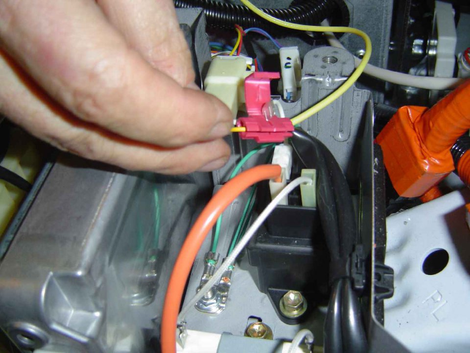

    there is a yellow wire in there, I am told that is the ready wire, on the car it came off was wired upfront by the hybrid computer, I allready have an EV button, I'm no stranger to that looks like I need to run the 3rd ready wire to the engineer swich.

    If you check youtube enginer installations, or pis installations, there is a ready signal you can tap into at the prius stock battery where the enginer + and -ve wires are fitted, but i am not too sure what colour wire you tap into. It saves you tapping into the ecu behind the glovebox.
    I have just checked and i beleive its the yellow wire I`ll send you some pics via email where it is located shortly.

    The switch on the case side of the bms is just the bms on or off. If you run the kit with the bms in the off position then you have no protection at all for the cells they can be overcharged and over discharged as the kit will work with the BMW off.
    I sent you a picture of the inside of the bms with the jumper in both on and off positions.
    I have been told never never plug or unplug the 9 pin battery just cables into the bms when it is on, if your doing work on the bms always switch it off, but remember to put it back on when your finished.
    The cell loggers are cheap £14 here in the uk for non logging ones or £27 for logging ones. Your choice which one to choose. AC relay was £10 and relay pcb's was £13 so quite a cheap mod to do for more protection on the charge side to cut off earlier.
    The converter has 2 drilled holes in the top cover, shine a small torch inside thro hole and should see a turn pot under each hole, (if they line up, mine did) the turn pot nearest end is the amps adjustment, the one nearest the bms is the operating voltage adjustment.
    They can output 15 amps apparently but then they are working hard and get very hot, not good for electronics. Mine is set to 11.5 amps.
    The operating voltage I have adjusted, as when the converter had cut off at voltage high set point, the prius battery state of charge was 60%, I wanted it more to 65% and in the prius battery green zone on the mfd. turned them pot clockwise very slowly over quite a few converter sequences until I got the pint where I was happy. I monitored this with the torque app on my mobile connected to they car via a Bluetooth bod adaptor, works really well but you have a scan gauge so that is good too.
    You will need a dc clamp meter to check the output amps are correct and if yu adjust the amps turn pot. I have also slightly modded the case with a fan of a pc to exhaust the hotnairnout of the engineer case when it's running to try to protect the converter from overheating. Heat and electronics is not good, hotter they get the shorter life they last by a general rule.
