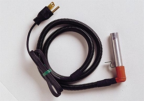

    Chapman has pointed out in different ways, that the biggest efficiency loss on Prius is driving during warm-up while the engine is in open loop. If you used an engine heater to preheat your coolant before every cold start, you would boost your mileage most of anything you could do...if the payback covered the Kwh used.
    I am considering putting a 1Kwh heating element in the cylinder head with a high limit thermo switch inline, and a contactor actuated by the power door lock receiver. If I plugged the car in whenever I get home, I could click the key fob 10 minutes before I leave the house and have a warm motor and instant heat at the defroster.

    We're using the block heater year round, almost without fail, for the first cold start of the day. Besides the faster warmup, it also imposes a behaviour change, makes you reconsider frivolous trips, or opt to use leg power for a short errand.

    I think you'll get longer engine life, too, as most engine wear occurs during warmup, when the lubrication on cylinders and guides gets diluted by enrichment fuel. And you're not getting excess fuel passing the rings, diluting oil in the base. Probably a candidate for extended interval oil changes, analysis would tell.
    When I was in the service, we kept the hot starts on our patrol boats plugged in 24/7 for easy starts and fast getting underway.

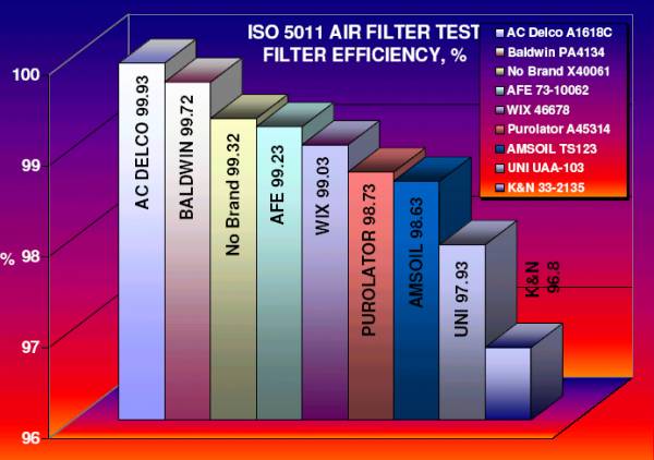

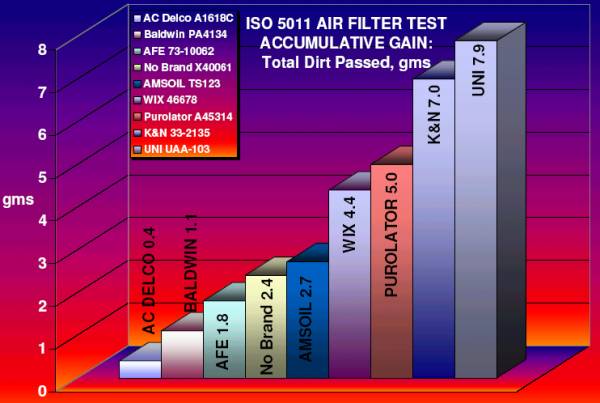

    Linked article reinforces the truth, that is unfortunately drowned out by all the marketing, and auto pats store wanting to increase profit margins w/ the expensive K&N type filters, and filter oil. At least we know, and can share this knowledge.
    The Nissan club testers, found the K&N filters let more particles pass through and gets clogged faster, than the cheap, but effective paper type filters.
    Filter Efficiency (How well does the filter capture debris.)
    Accumulative Gain (Total amount of dirt that passed through the filter.) kn-v-oem (accumulative gain).jpg

    Thanks! Just read the block heater ad. Anybody know how high this sits in the engine? I really want to just heat the coolant in the head, to stimulate the ecu's coolant temp sensor, not the whole water jacket down around the cylinders. Agreed this can't be done right with HV battery power, tho I think I could make my fob remote trigger the 110v. power on. Not so much worried about using it in winter, but all year, as Lesik, and my MFD indicate.

    Um, I think I said most of that, but not the open-loop part. What I tend to see with a ScanGauge is that even from a cold start, the ECU transitions from open to closed loop control within something like a dozen seconds. Mileage is bad for about the first five minutes. Bob Wilson has graphed volumes of data showing how bad and why.
    I think the engine-block heater sold by Toyota is more like 300 W than a kilowatt. Advantage is it fits right into the recess designed for it. You can find a lot of threads where people have gathered data on how much benefit comes with how many minutes of preheat. If I remember how it fell out, you might want a timer to start it one to two hours before you plan to leave.
    I'd question how much benefit you'd get just by fooling the water temp sensor. I think the reduced efficiency during warm-up is more because the engine is cold, not so much because it thinks it's cold.
