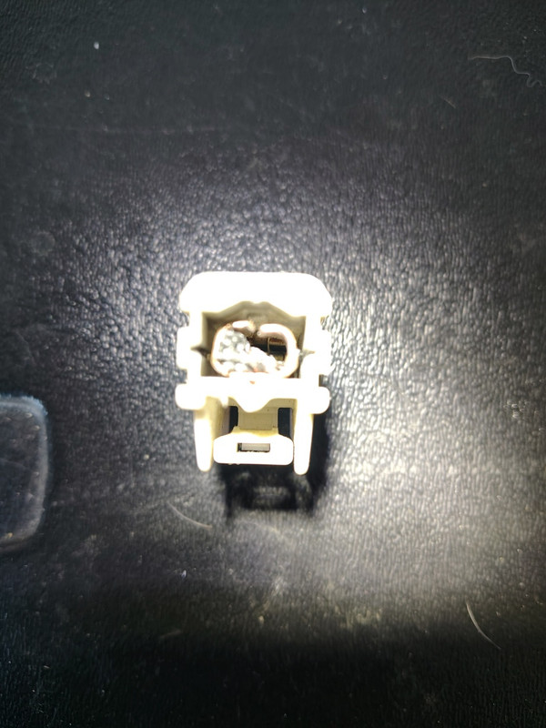

  5. bisco
    115,377
    52,808
    can you post a pic of where it plugs in?

  7. bisco
    115,377
    52,808
    that's a tough one. can you strip it back and tuck it into the positive cable clamp?

  9. priuslyfe
    priuslyfe Member
    Dec 20, 2021
    343
    70
    43202
    DANG! it looks like this is the complete wiring harness. the other end MIGHT just clip onto another white clip thing before it attaches to the longer wire. Really don't feel like working out in the cold but oh well. HOPEFULLY, otherwise looks like I have to figure out a workaround.

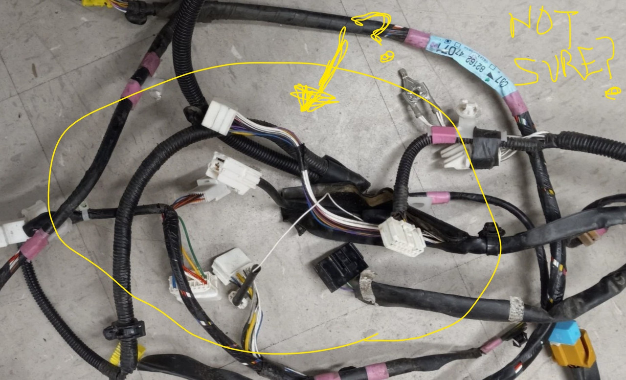

  11. priuslyfe
    priuslyfe Member
    Dec 20, 2021
    343
    70
    43202
    Looks like I might have to figure out how to get extend the existing positive cable into this white clip. Seems as though the wires are welded into the clip because I can't pull it out with either needlenose pliers or trying to scrape it out with a flathead screwdriver.
    Any ideas on how to remove this wiring remnant?
    Can anyone tell me where the "fat cable" I need is on the wiring harness? It might not be the one I thought it was as I went outside and searched for it and can't find a white-clip immediately.
    also thinking of trying to find the other end of the positive cable clip so i can at least pull one from anotehr car if need be. Not to mention much easier if it only needs a short length until another clip.
    which white clip on here hooks up to the positive battery-cable black housing above??? Kinda like solving a puzzle to find it. i think its the circled area cable but not sure....
    2007 Prius floor harness....
    closer picture:
    #11 priuslyfe, Feb 1, 2026

  16. ChapmanF
    28,691
    18,996
    Usually, he 'canonical' repair when a wire breaks out of a connector like that starts with looking that connector up in the wiring diagram, as you see in this example and this one (which are looking up a different connector, of course).
    That gives you the Toyota part numbers of: the plastic housing, a 'repair wire' that already ends in the right metal terminal, and a crimp sleeve of the proper size to attach the repair wire to the end of your existing wire. The diagram will also have a picture showing how to release the old broken-off terminal out of the plastic housing, so you can clip the new one in. (So, the part number of the plastic housing itself you don't usually need, you just reuse the one you've got. Sometimes people do break the plastic housings, though.)
    It's possible, though, that Toyota doesn't list a repair wire or crimp sleeve for this particular connection (I haven't tried looking it up just now, but I'm having some déjà vu about it), because it is a thicker wire than they expect you to be equipped to repair.
    I would then head for a salvage yard to find a car that still has that wire so I could hack off the last foot or so, and then I'd go straight to my neighborhood independent auto electrical shop. They do have the big-@ss crimp tools right there to splice that back on the existing wire, and they'd have it done in a couple minutes and not charge me much.
    That's a pretty thick sturdy copper wire. But I've seen at least one other thread here where it got weakened by corrosion and broke off there. I'm guessing if the OP broke it off by unplugging and replugging, it might have been about to cause some trouble anyway.
    That said, you do want to be careful not to put a lot of repeated bending on the copper right where it goes into the terminal. When unplugging/replugging, it's better to spread the flexing over as great a length of wire as you can. Might be tricky with that one, as there might be a harness clip or tape immobilizing that wire not very far back from that connector.
