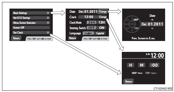

    On the c it's a steering wheel button.
    The clock setting procedure is also clearly totally different (using an appropriate sequence of using the DISP and TRIP buttons in conjunction with the Multi-information display.
