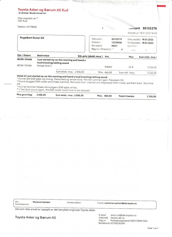

    Serviced my car at a Toyota Service Center and they just cleaned the EGR as they said it was clogged. Talked to the work shop guy and said that they just cleaned it so for me to be able to save some expenses. They were asking if I was driving short range and told them that I drive 120km vice versa from home to work. However, told them that when I bought the car a year ago it had only went 59,000kms. They said that it maybe one of the reason. I paid $330 for it. See uploaded file.
    Question:
    * Is it normal for a Prius V to have a clogged EGR at 95,000kms?
    * If cleaned, does it fix it or is it a temporary fix?
    * If only a temporary fix, on average how much kms does one drive before it come up again?
    mikey_t likes this.

  5. rjparker
    rjparker Tu Humilde Sirviente
    Jun 6, 2008
    10,995
    6,892
    Texas Hill Country
    It will partially clog again, likely to the same degree in the same timeframe. Primarily because gen3 egrs draw exhaust gasses before the catalytic converters clean them up. A secondary issue is 2010-2014 Prius engines have flawed piston rings that often cause excessive oil consumption that ends up in the egr cooler passages. Some early gen3s with frequent oil changes do better on oil consumption. Both issues were redesigned on gen4 engines. Most Toyota mechanics do not clean or replace egr components unless specific egr related codes are generated.

  7. Mendel Leisk
    61,414
    42,254
    Looking at the invoice it does appear they were thorough, which is a little surprising. Hopefully that's the case. For more info on what's involved in the cleaning, or if you'd consider DIY to see first-hand how well it's cleaned: see the first link in my signature.
    How many hours did they have the car? If only an hour or two I'd be skeptical about the efficacy of their cleaning job.
    mikey_t likes this.

    I was looking at a link on YT on how to clean it and if you dont have the right set of tools then it'd really be an issue. o_O
    They were saying about 3hours of work on it. I will try and ask them specifically about the EGR cleaning only.
    What would be the best advice? To trade it in considering that it has gone through this issue already? After a long drive to work today I have observed that it doesnt switch to EV as often as it does before. Idk if it has something to do with it.

  9. rjparker
    Jun 6, 2008
    10,995
    6,892
    Texas Hill Country
    My guess is the egr cooler and intake manifold was not clogged but simply had normal buildup. A completely clogged egr will produce specific codes. Egrs are normally closed at startup and low speeds anyway. The earlier gen2 Prius did not have one at all.
    Primarily, an egr reduces emissions slightly and leans the fuel air mixture at highway speeds to improve mpg. The fact your mechanic could do it in three hours means he was good and the egr cooler and manifold did not need major cleanup.
    As far as trading it, here in the US a 60,000 mile gen3 engine like yours is usually in very good condition and is often sought after as a replacement engine for a 200,000 mile car. Change oil frequently, every 3,000 - 5,000 miles. If you have no more rattling over the next two months, you are probably good. If it does rattle, a trade might be prudent assuming you can find an affordable upgrade.

  17. pierced
    pierced Junior Member
    Jan 30, 2021
    Norway
    2012 Prius+ MPV
    Business Edition
    I called them today and asked how long they worked on it as I dont see it in my invoice. They told me that the report was 2.5hrs just for cleaning.
