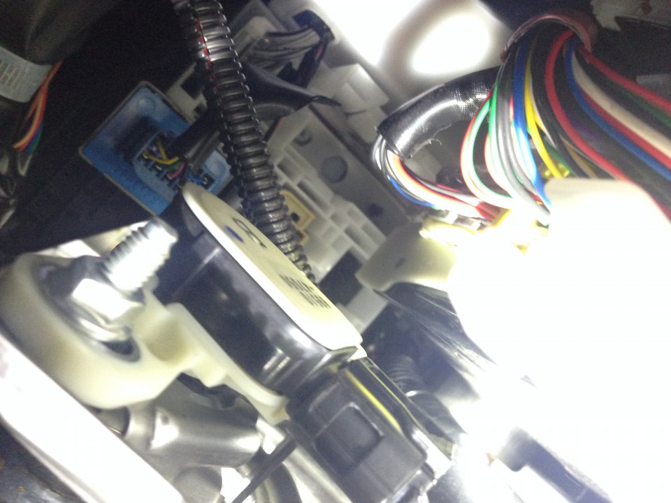

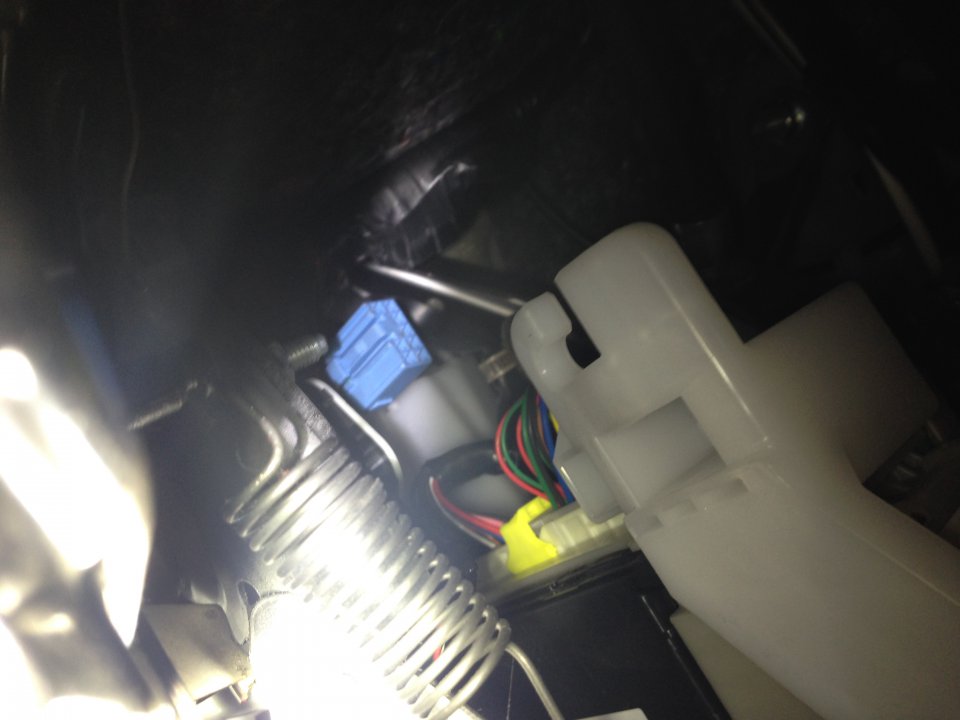

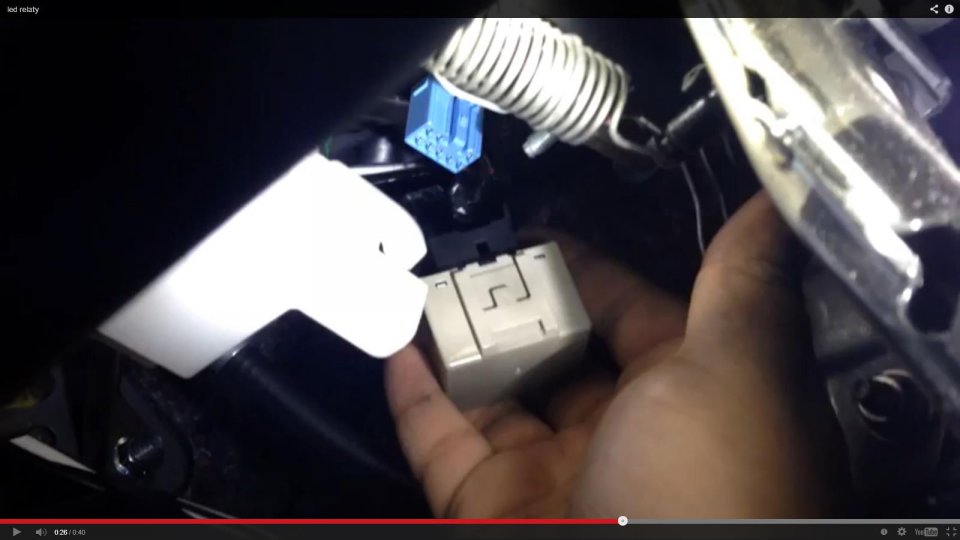

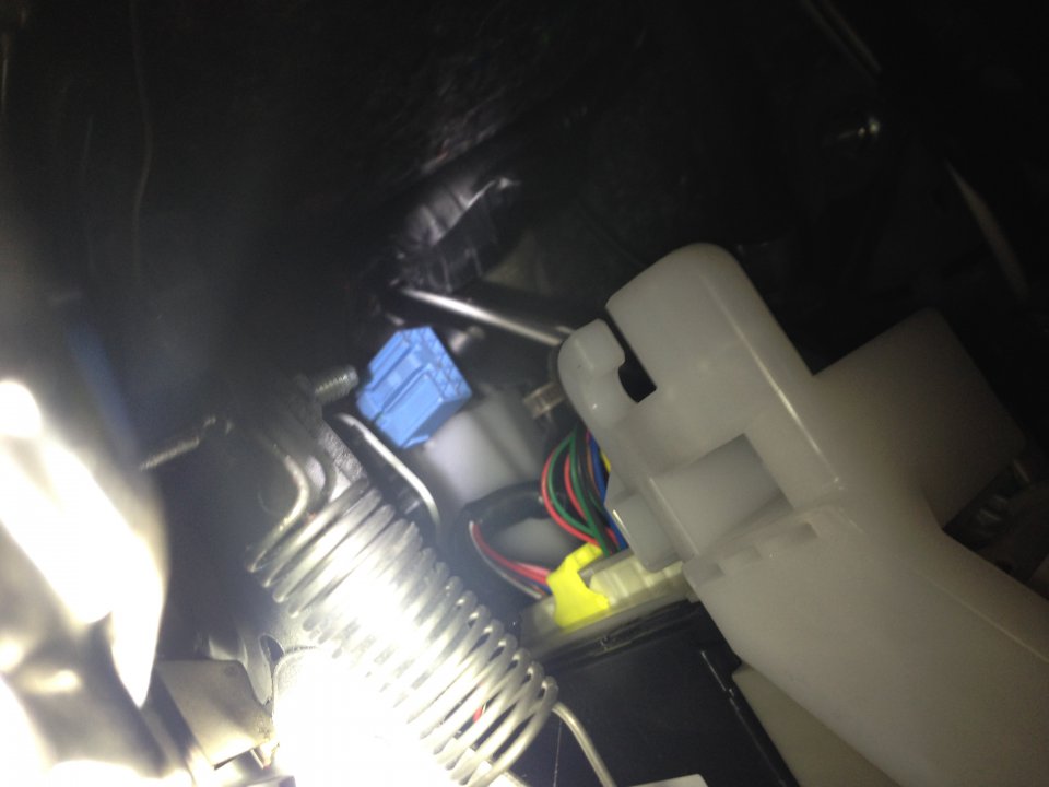

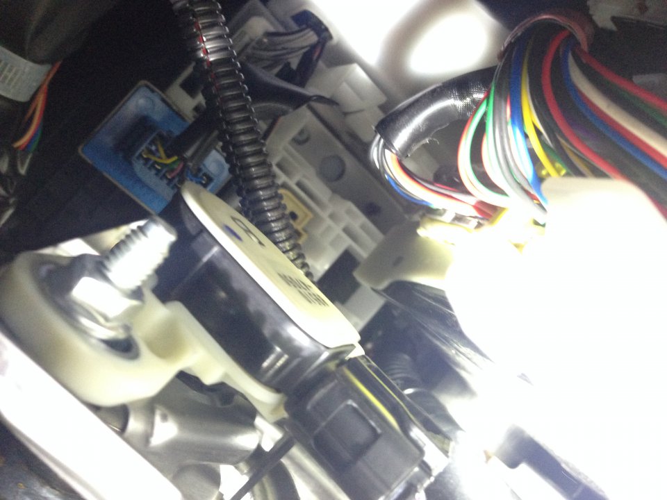

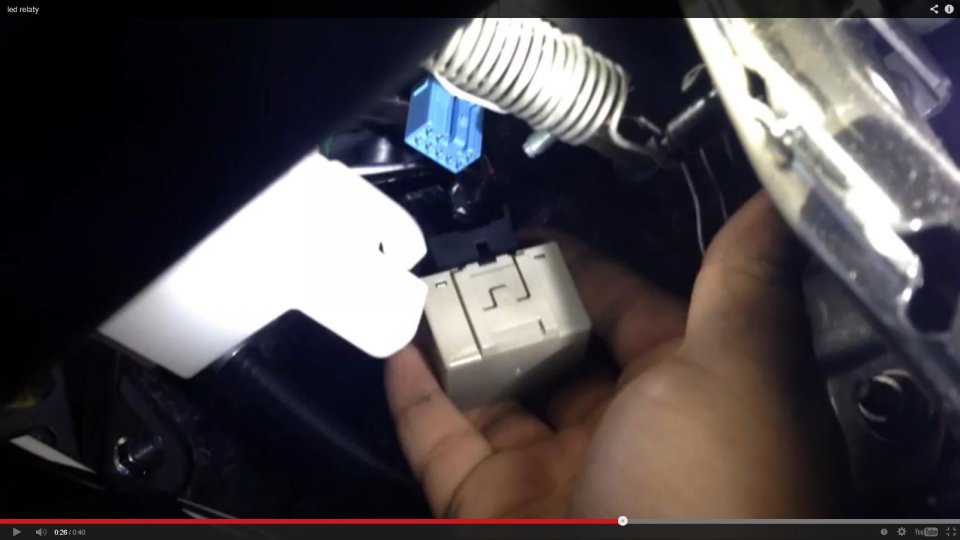

    one is also able to plank on the door sill and have the head adjacent to the brake pedal. Another tip is to turn on the turn signal and use your hearing and touch senses to locate the really once in that position. I have attached a video which shows the factory relay location and I IMG_1510.JPG IMG_1512.JPG have attached photos of the connecter so one can understand where to put pressure on the plug to disconnect it.

    Thanks, this photo recon is very helpful.

    My back hurts just watching the video. :(
