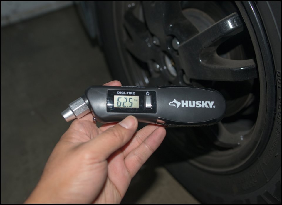

    I bought my 2014 Prius Three in November, but I never checked the tire pressure until yesterday, and I was blown to see that all the tires had ~63 PSI on them! But even with this high pressure and hot weather, my MPG is still abysmal at 38MPG average. Should I lower the tire pressure? They feel "ok" to me as-is..

    I would check the pressure somewhere else as 63 is crazy high and most likely a lot more than max psi!
    Reduce to 40s and enjoy the comfort in comparison

    Lower your tire pressure to Toyota specifications that are on a label inside of the driver's side door. You are way too high. Adjust the pressure in the morning before you drive your car.

    Sounds like the tire pressure was never lowered after it came off the boat. The tires are kept at high pressure for the sea voyage, why I don't know, but my 98 Camry was delivered with over 50lbs pressure per tire, and it took me 3 or 4 days of hard riding to discover it.

    If you are ok as is, I wouldn't bother messing with them.
    I've never really gone much above mid-50's myself, but even at your current level you are nowhere near the true bursting point of the tire.
    That said, for customers I never set them that high unless they ask.

    Double-check pressure with another gauge as first step as that is way off the pressure it should have from dealer. If confirmed high, the dealer prep was faulty and you might want to switch dealers and have it checked over just in case.
    But very odd your mpg is also so low. Is there an experienced Prius driver in your area who could analyze your driving style? Or he/she could test drive your car with a reset trip odometer to see what mpg can be achieved. If they cannot get 50-ish mpg in normal traffic and moderate speed conditions, you really should have all systems thoroughly checked.

    63 PSI is dangerously high! I second the motion that you check your tires with a known accurate gauge.
    How do you keep you dentures from falling out with the tire ballooned up like that? The ride has to be exceptionally harsh.
