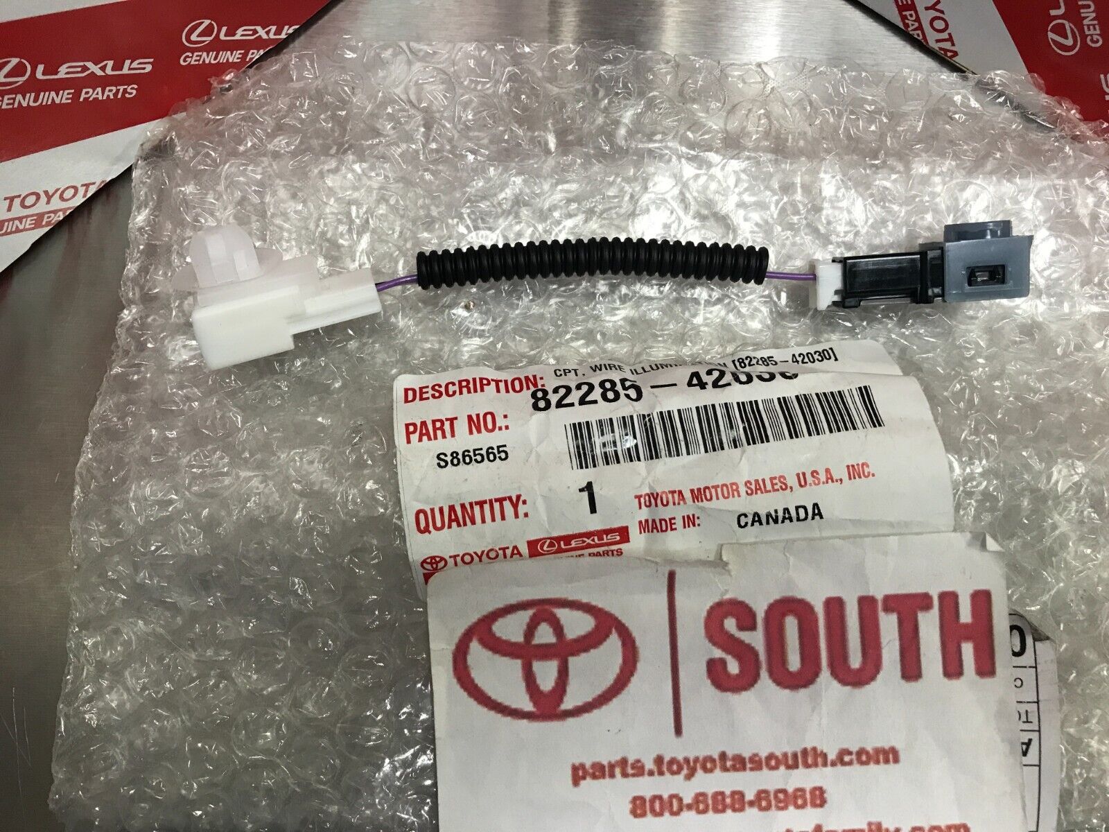

    First, some background: Toyota does not supply parts to dealers. It supplies them to parts-distribution centers. You call the dealer, and they place a "special order" with the parts-distribution center, and the part will arrive from the nearest parts-distribution center. And the part arrives to the parts-distribution center from Japan.
    Almost every part, including this LED bulb, is sold as singles. They are neither packaged nor sold as a pair. So, if you order this LED bulb, you will get a single bulb in its original bag or box shipped from Japan, like the following LED bulb (actually this one is from Canada LOL):

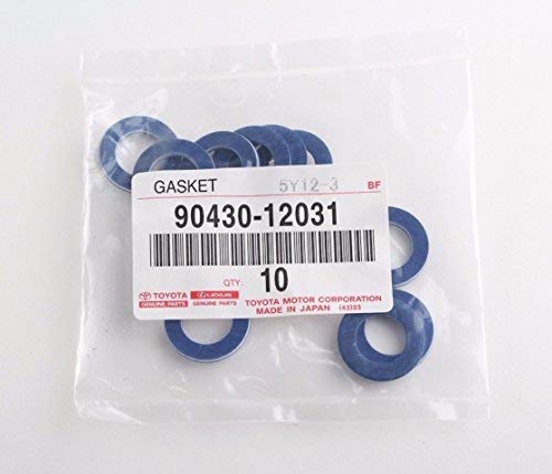

    The only things that come in multipacks are small parts like clips etc., which come in bags of ten, like my picture of the oil drain-plug gasket above. And, yes, as you said, these small parts will then be taken out of the bag of ten and separated according to the order—either at the distribution center or at the dealer. However, this is never the case with bulbs or bigger parts. Besides, if you put more than one bulb in a bag, they could break. ;)

    Off topic…but the sales person would give me these gaskets for free when I buy oil filters from the Lexus dealer I go to.
    Gokhan likes this.
  20. Gokhan
    Gokhan Senior Member
    Oct 5, 2008
    6,693
    2,651
    Paramount CA
    Yes, and some other dealers also put a "free" gasket in the oil-filter box. They cost about a buck each though—perhaps about 50¢ to the dealer. At one point, these gaskets were causing oil leaks because they were made form a very hard springy cork-like material. leading to self-loosening of the oil-drain plug. Toyota eventually replaced them with the blue soft-gasket-material-covered aluminum gaskets I pictured above, which solved the problem. I went ahead and bought a full bag of ten once (it cost me about $10, not about $1 ;)), and I was able to use less than half of them before my old car got totaled by a hit-and-run driver. My blue 2021 Prius Prime Limited gets a $50 oil-change/tire-rotation/multipoint-inspection service at the dealer under the AdvantageCARE policy every six months.
