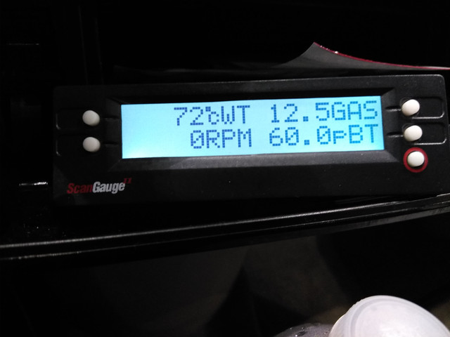

    And I purchased ScanGauge 2 From advanced auto with coupon for total of $130~

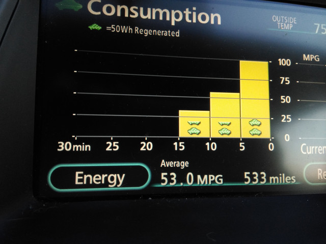

    And by the way I decided to do full-to-full gas tank test and see if the trip computer shows correct and amazingly it does I had around 1 gallon gas left I believe although the scangauge2 shows every 2.5% . The pictures are from the test with the 87 octane while doing UBER in Chicago, so car has 1-2-3 passengers at much of the time. - 53 MPG. WOW. What a car

    yes, i forgot that some distance isnt measured. The difference is 2% which on 533 miles is 10.66 miles, thats probably around 1 mpg more than what it shows.
